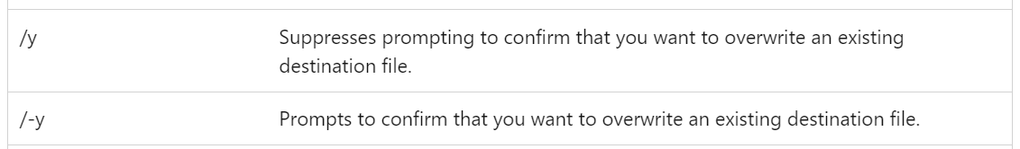

As a very simple and related example, look at the below for two parameters of the xcopy command. I use "/y" all the time because I don't want to be bothered with any prompts to overwrite a file and the ask here is the same: Provide a option to overwrite the backup file without prompting the user.

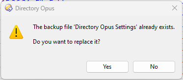

When the Prefs command is executed to backup the settings. Here's the command I have in my button:
  • Prefs Backup=all to "Directory Opus Settings" QUIET
Note that I purposely removed the folder name for privacy reasons. The popup that appears is:
This is not a big issue for me because I am always in front of my computer when I do the backup and I always simply just click "Yes." However, it would be nice/convenient to add an option in the Prefs command that would simply bypass the popup and assume "Yes" was clicked.

But that is only going to happen if there's already a backup with the same name. Delete (or rename or whatever) that backup first and you won't be prompted.
All clicking "Yes" in that dialog will do is delete the existing file before creating a new one. So if you make your auto-backup button delete the first, you get the same result without the prompt.
