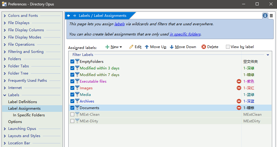

A:
Switch to a light theme, Open [Preferences/Labels/Labels Assignments],
assgin some labels to your filters.
Then we get the file:foldercolors.oxc.
Copy "/dopusdata\ConfigFiles\foldercolors.oxc" to "/dopusdata\Themes\Light\ConfigFiles"
B:
Switch to a dark theme, Open [Preferences/Labels/Labels Assignments],
Then we get the new file:foldercolors.oxc.
Copy "/dopusdata\ConfigFiles\foldercolors.oxc" to "/dopusdata\Themes\Dark\ConfigFiles"
This is my label assignments:
