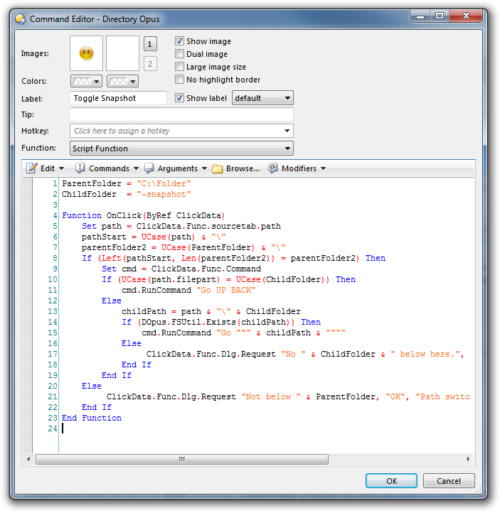

Set the Function drop-down to Script Function and use this:
[code]ParentFolder = "C:\Folder"
ChildFolder = "~snapshot"
Function OnClick(ByRef ClickData)
Set path = ClickData.Func.sourcetab.path
pathStart = UCase(path) & ""
parentFolder2 = UCase(ParentFolder) & ""
If (Left(pathStart, Len(parentFolder2)) = parentFolder2) Then
Set cmd = ClickData.Func.Command
If (UCase(path.filepart) = UCase(ChildFolder)) Then
cmd.RunCommand "Go UP BACK"
Else
childPath = path & "" & ChildFolder
If (DOpus.FSUtil.Exists(childPath)) Then
cmd.RunCommand "Go """ & childPath & """"
Else
ClickData.Func.Dlg.Request "No " & ChildFolder & " below here.", "OK", "Path switcher"
End If
End If
Else
ClickData.Func.Dlg.Request "Not below " & ParentFolder, "OK", "Path switcher"
End If
End Function[/code]
