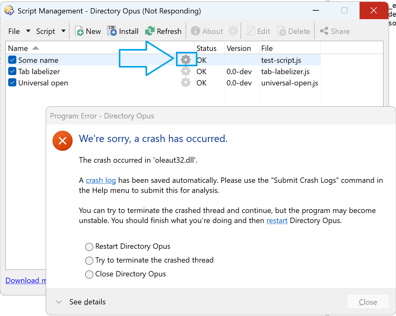

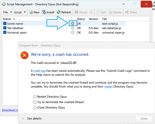

This is the minimal reproduction scenario that also causes a crash on my machine:
function OnInit(/* ScriptInitData */ data) {
  data.name = "Some name"
  data.default_enable = true
  data.config_desc = DOpus.NewMap()
  data.config.someConfig = [] // <-- This is probably not allowed, it should be a string
That's what I thought, yes. I don't think you can assign an array to this property.
And this is the same dll involved in the exception on my side (except I couldn't even get the script dialog content to appear, it crashed before that).
