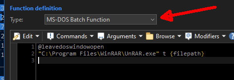

Could you post the command you have right now?
This is in Standard Function
@nodeselect
"/programfiles\WinRAR\WinRAR.exe" t {filepath}
Try unrar.exe instead. Should be in the WinRAR folder as well and also takes the t command.
Strange, it works fine for me and looks completely different.

Note this:
Btw, instead of @leavedoswindowopen you can also add a line at the end with pause - then you just have to press any key to close the window.
Hth.
