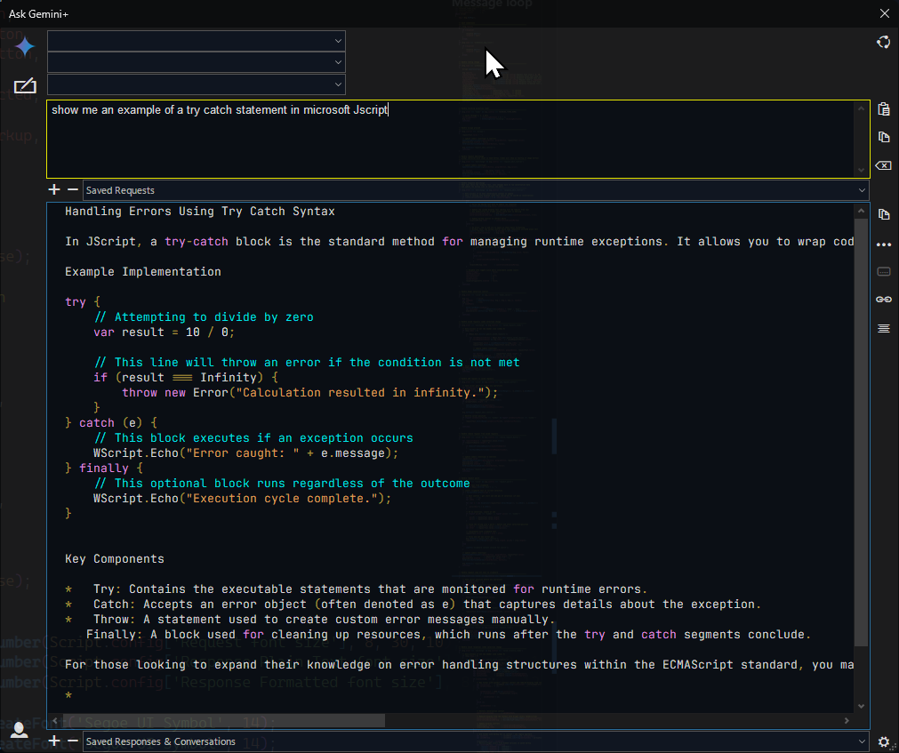

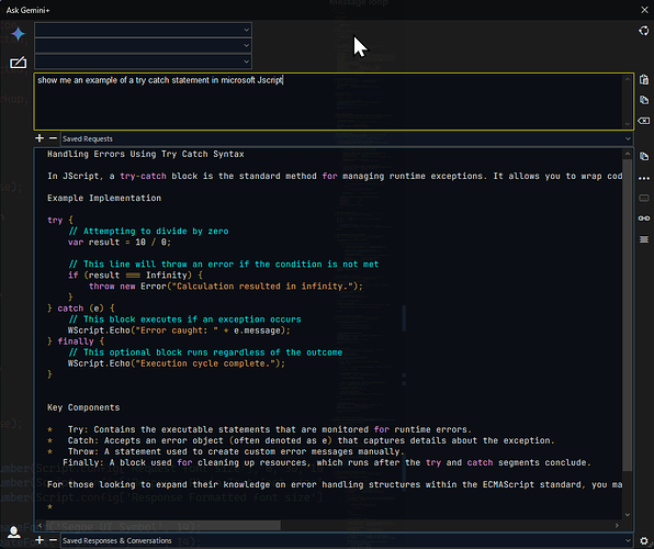

Here is example dialog where setting fonts (which is possible from config settings in edit mode) might come in useful. (also word wrap) :slight_smile:
For those interested: if you want to switch between the standard (multiline) text edit mode and the new code edit mode of the edit control, you cannot set the mode dynamically, but you can of course duplicate your edit control, rename it (from “texteditor” to “codeeditor” for instance) and set its properties enabled and/or visible to false. (You can then move it out of your way by making it smaller and move it somewhere at the bottom of your visible editor control.
PS. This inactive control will remain visible in your Opus code editor, but that should not be disturbing: it’s just reminding you that it is there, so to speak. For instance:
