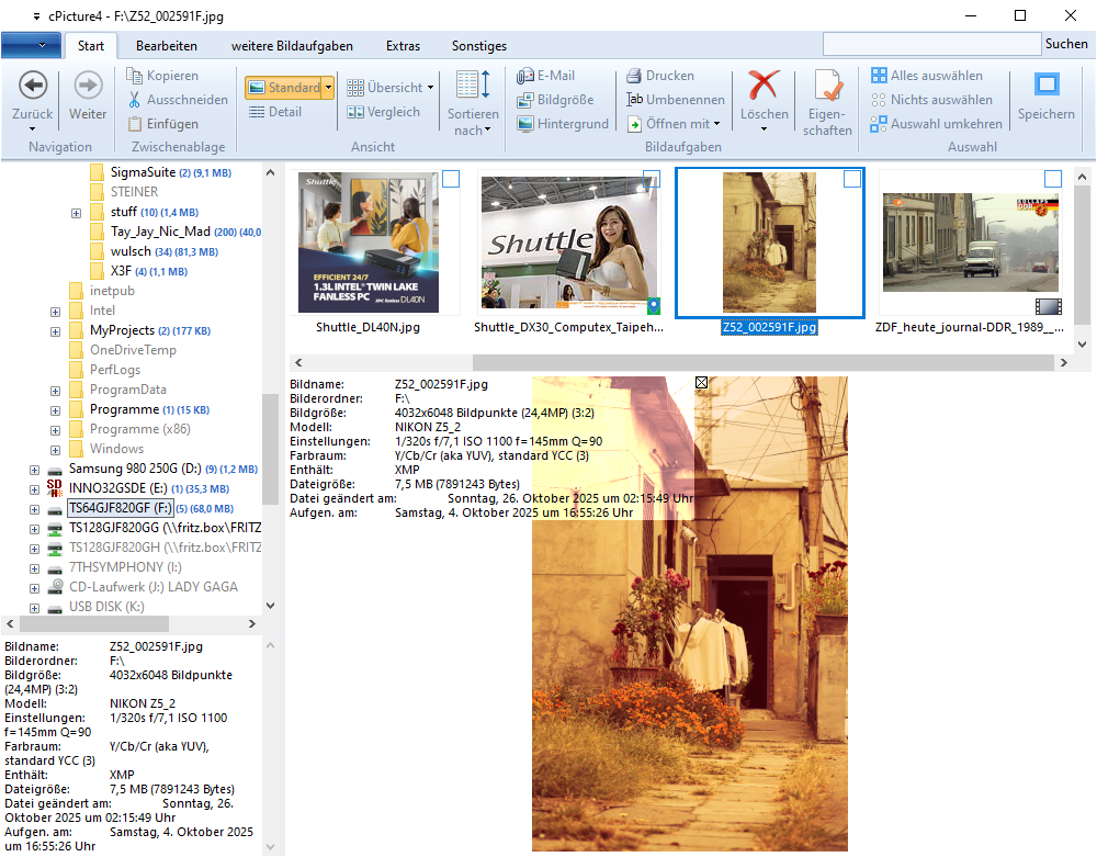

Here is the cPicture rendition:
You see that it reports the color space as "Y/Cb/Cr (aka YUV), standard YCC", which is taken from the JPEG reference source (file jpeglib.h):

Then it reports "contains XMP".
Interestingly, the image seems to be differently rendered in the thumbnails strip above than in the single preview below.
This shows the ambiguity resulting from such practice.
