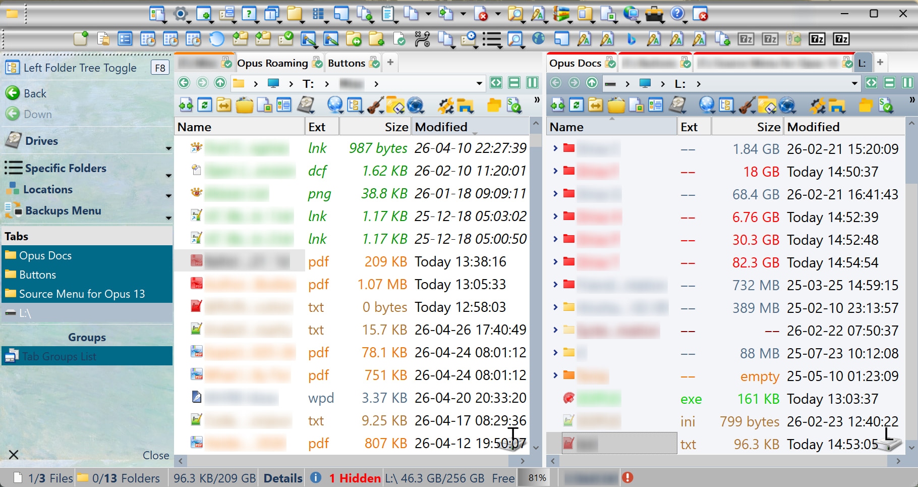

Here is a screenshot of a standard vertical toolbar on the left of the dual displays. How can I control the width with a MAXWIDTH sort of feature?
Depends what the commands are.
Your "Left Folder Tree Toggle" label looks like it would be pushing the width out the most; that's a custom button so you can just change the label yourself to make it shorter.
I do realize I could change the width of labels in the toolbar or turn off labels altogether for the toolbar to decrease the width of the toolbar. I was wondering if it were possible to do it at the level of the toolbar itself.
