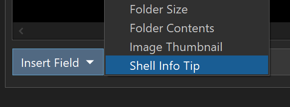

I would like to use third party info tips when I hover over an audio file. In this case the info tips from DB poweramp. It's working in Explorer but not in Dopus. I have disabled info tips in the preferences. Is it anyhow possible to use third party info tips?
Go to Settings > File Types, edit the info-tip for the Music file type group, and add the Shell Info Tip field to it. That should add any info-tip data you see in File Explorer to the info-tip in Opus.
Thank you very much. It is working!!
