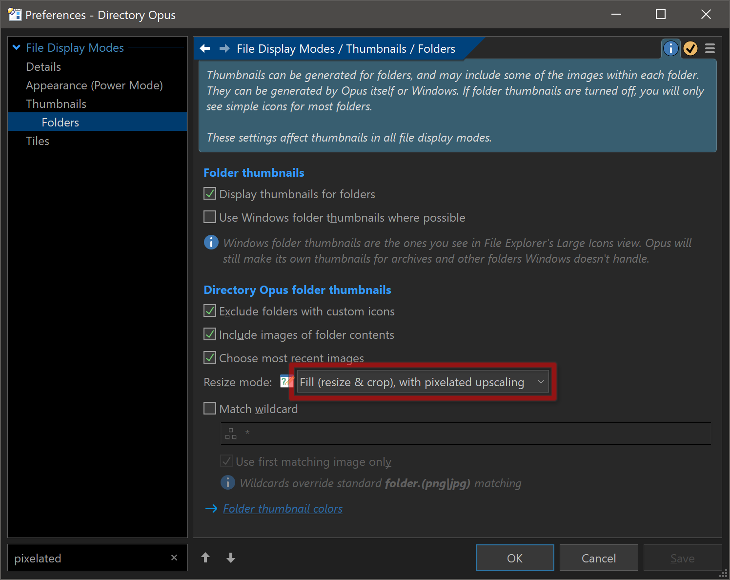

There are new settings for how thumbnails (for some file types) are scaled up when the image itself is smaller than the thumbnail size. Those can make things look pixelated, depending on which mode is chosen.
If you type "pixelated" into Preferences it finds all the related options. Each one also has a button on the left which copies the choice to all the other modes, if you want them all the same. (It can also be overridden for specific folders, if needed.)
I believe mine is identicle to yours. I assume you are saying that those are the correct settings.
here is mine
As I said things seem to be correct after clearing cache. hope that helps

When the folder has more than one item that has a thumbnail the images are each 1/4 of the folder icon, but when there is only 1 thumbnailable item the image is 1/1 on the folder icon. The the preview gets expanded to fill the folder icon. On 12 it stays as the 1/4 but is in the middle instead of one of the corners. I tried change the settings you showed to not scale the image up, but that didn't fix the problem. I assume I don't have to clear the cache when changing that setting. I also tried the smooth upscaling option to try to make it look less pixelated, but it didn't seem to change it.
I tried to compare settings in 12, but it seems things have changed a lot. I can't figure out what keeps it small on 12. I am fine with the large image, but i need a way to make it look "not horrible"
edti: when the icon is 1/4 it looks fine, but when it is 1/1 it is badly pixelated even when choosing smooth upscaling.
"Correct" depends what you want.
The options that say "pixelated upscaling" are not correct if you don't want pixelated upscaling. Change it to one of the other options, whichever does what you want.
