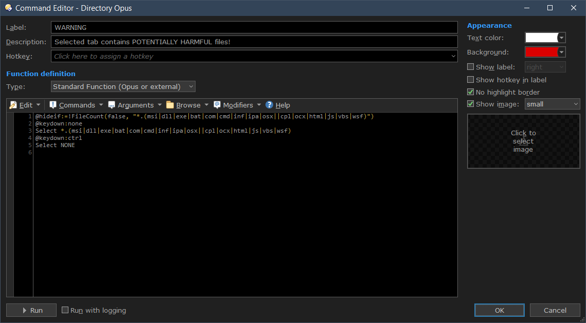

Thanks for the response. I currently have an evaluator button set up as follows:

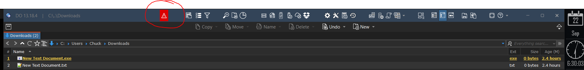

It appears as follows:
I would rather click the button to select the items, then click the button again to deselect them, if possible.
As I understand it, one can't mix scripts and evaluator code, which may make this moot.
Thoughts?
