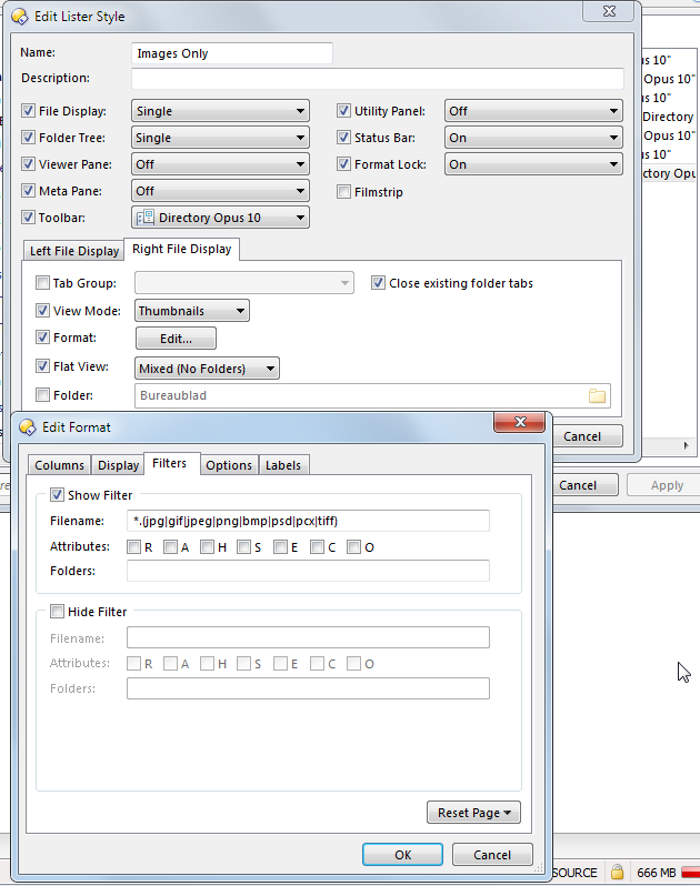

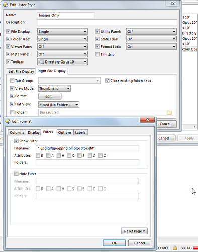

Whilst writing, just come to think of it.. maybe this can using styles?
later
I guess this may be going into the correct direction... :wink:
When you get this sorted, check out the grp: token in the Pattern Matching Syntax. It might be a way to improve your filter by using grp:Images.
Lateron: regretfully my idea doesn't work. It still shows other extensions as well.
