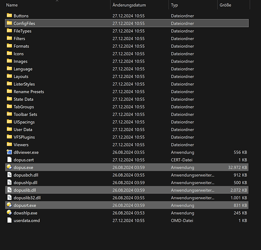

I just made a fresh export from my fixed installation to a USB drive, and it looks like this. There's program files, DLL's and configuration files all mixed together in one folder, and among the folders there is one folder called "ConfigFiles" which obviously is not the only place where config files are saved.
I don't think this structure is a good idea.
So is there a way to clearly separate program files and config files in a portable installation?
