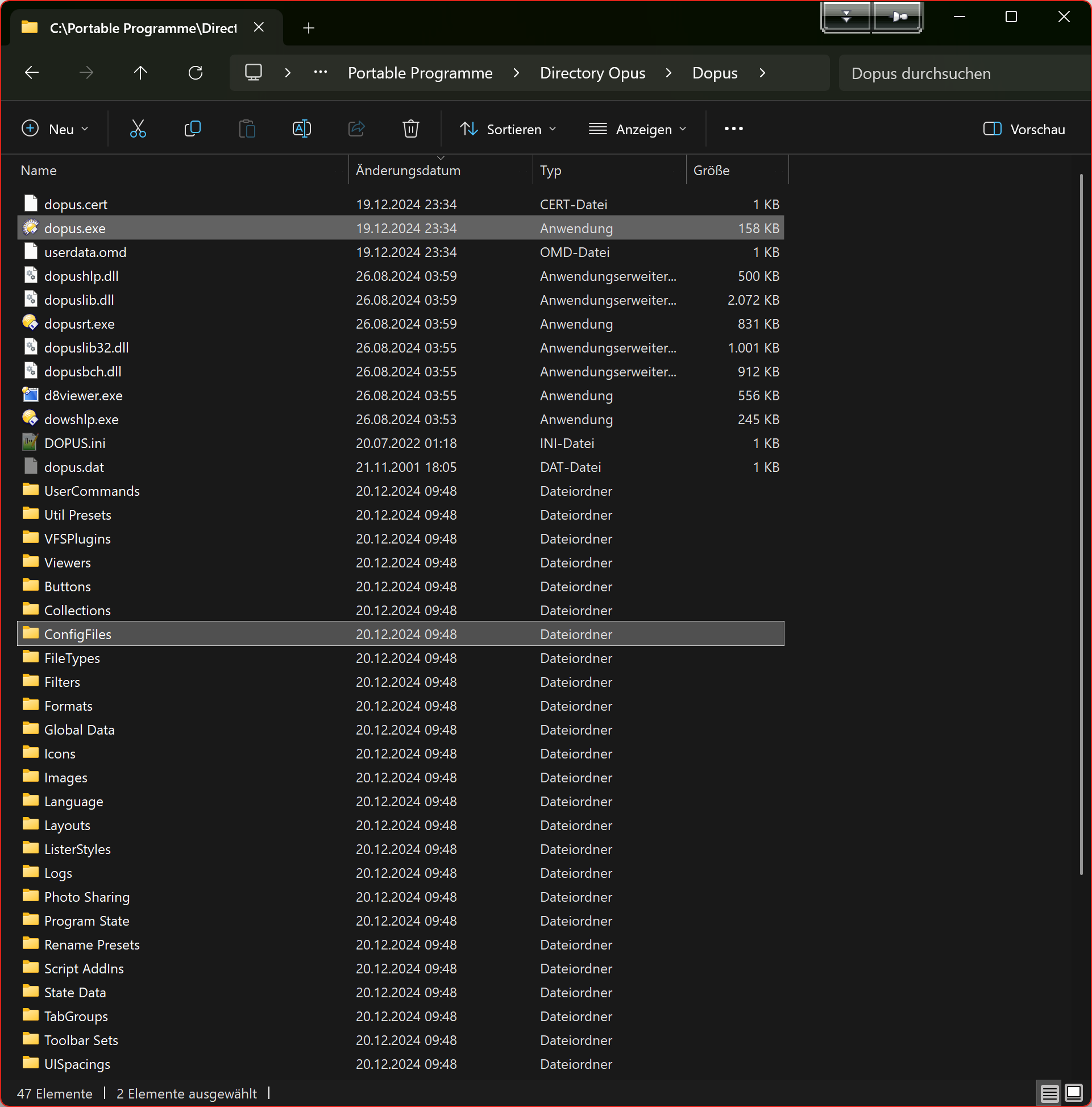

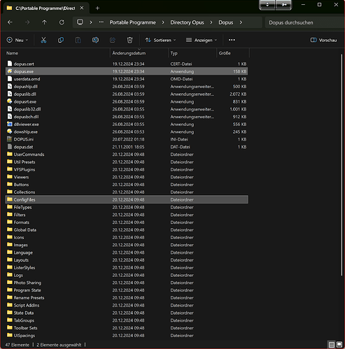

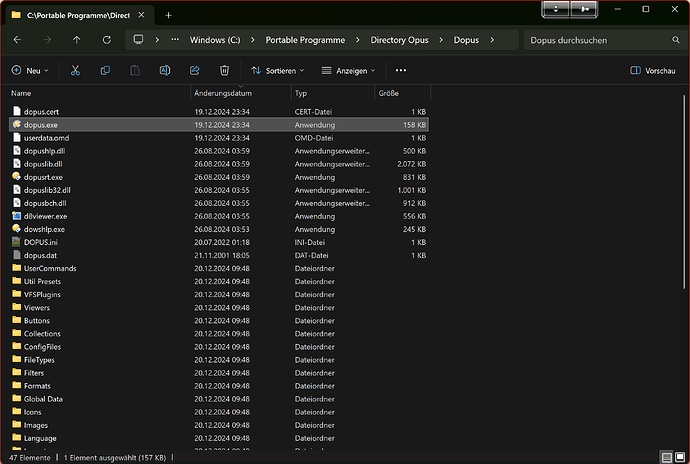

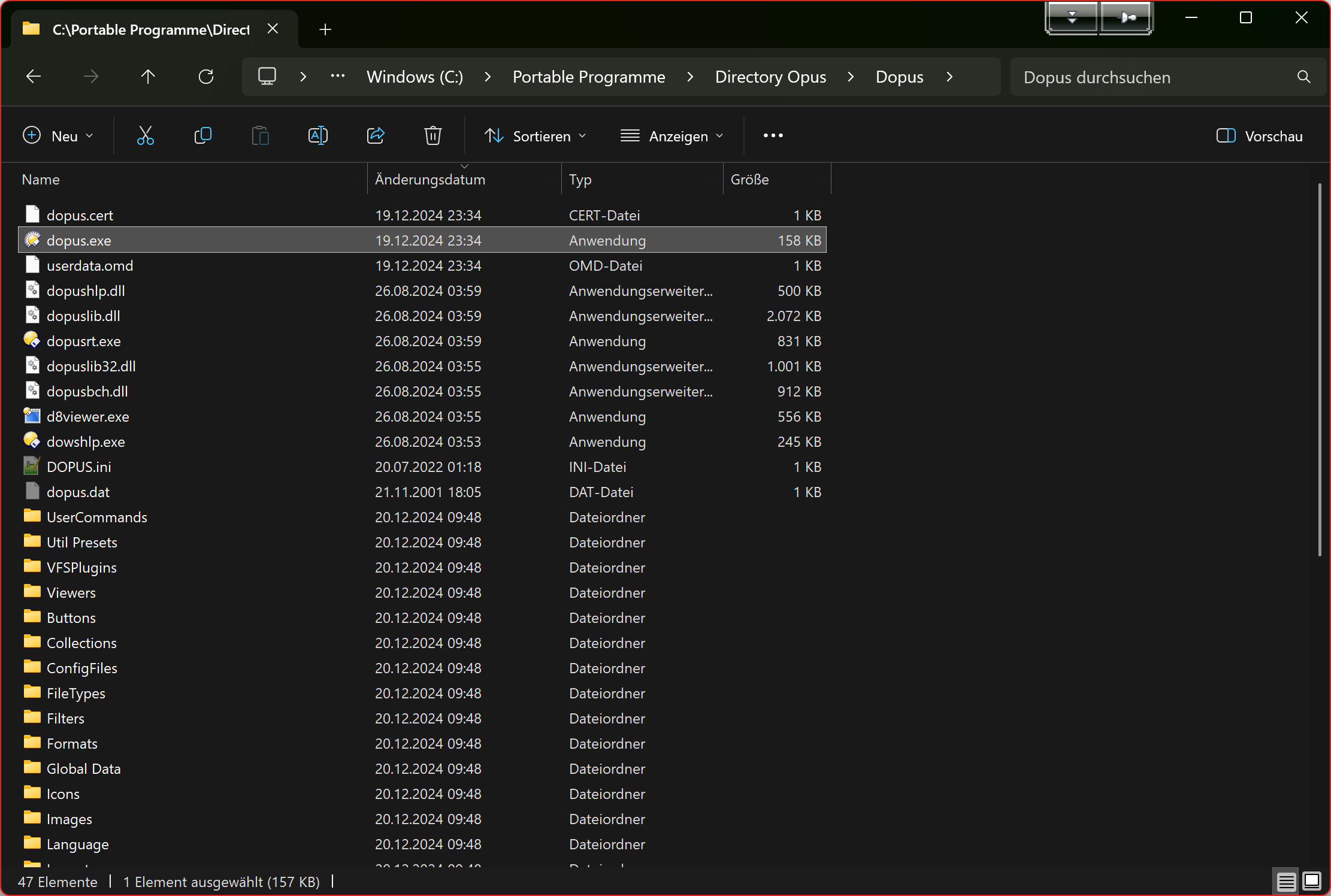

My issue is that I can’t properly differentiate between program files and configuration files because the folder C:\Portable Programs\Directory Opus\Dopus seems to contain both types of files on the same directory level. Additionally, the parent folder C:\Portable Programs\Directory Opus contains another copy of Dopus.exe and Dopus.ini.

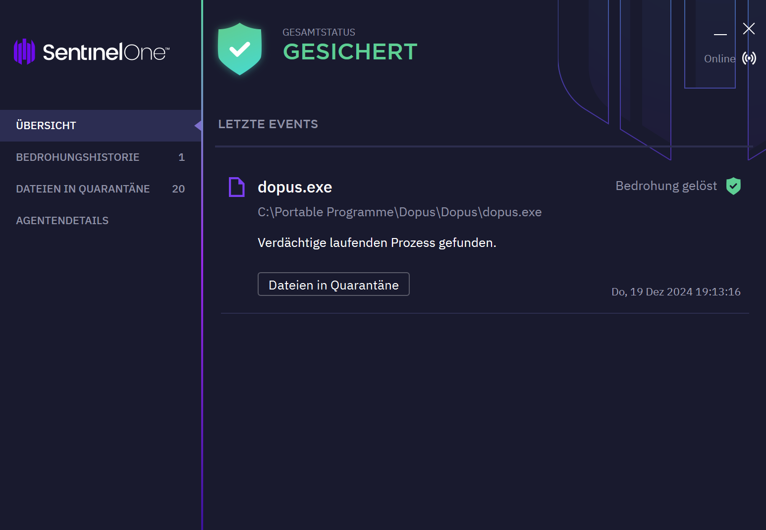

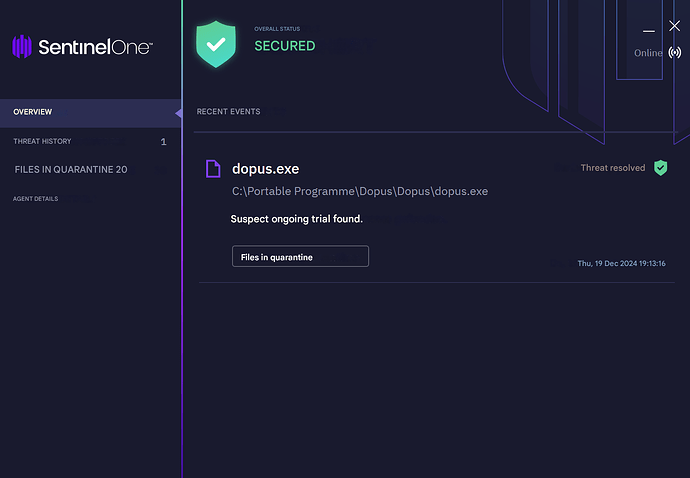

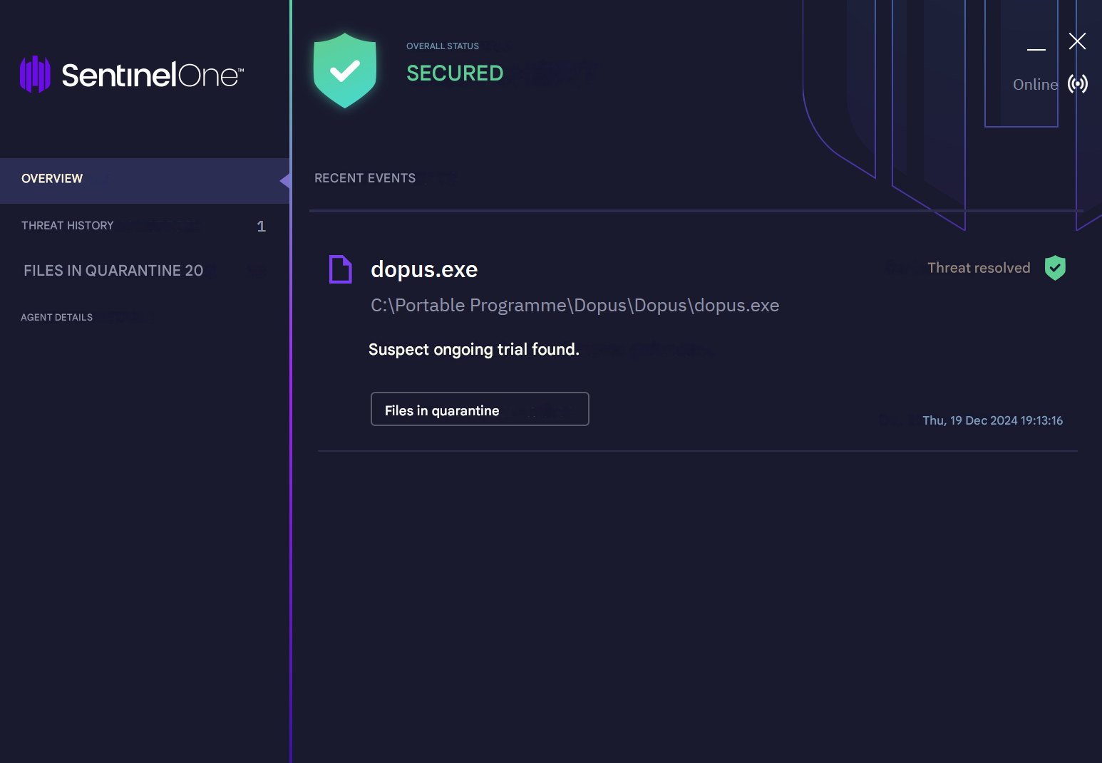

I forgot to mention that the issue started when SentinelOne flagged Dopus as malware and quarantined dopus.exe a couple of days ago. I believe that this happened because I opened an infected file from within Dopus and not because it recognized Dopus itself as malware.
To address this, I:
  1. Made two copies of the portable installation folder.
  2. Restored dopus.exe from a backup in both the original folder and the copies of the portable installation folders.
Afterward, I performed the upgrade as described above, and everything worked fine for a couple of days.

Additionally, I’ve noticed that I now have about six copies of the ConfigFiles folder:
  • Some are in the root directory of one of the portable installations.
  • Others are in the Dopus subfolder within a portable installation.
Could you please clarify:
  1. Which folder should exclusively contain configuration files, and which folder exclusively program files, if applicable.
  2. What is the standard directory structure of a portable installation, is this shown somewhere in the documentation?
This would help me reorganize everything using the backup copies I have.
