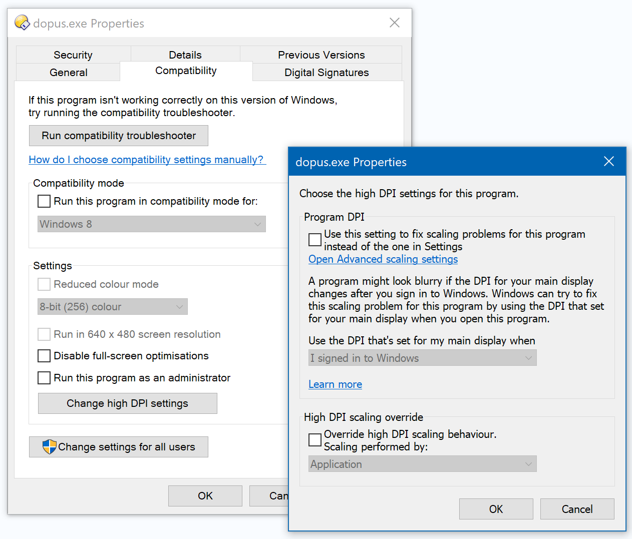

Something that can cause confusion is if any of the Compatibility settings have been turned on for dopus.exe. None of these should ever be turned on:

My settings in the dialogue boxes are exactly the same as yours above, and have never been any different.

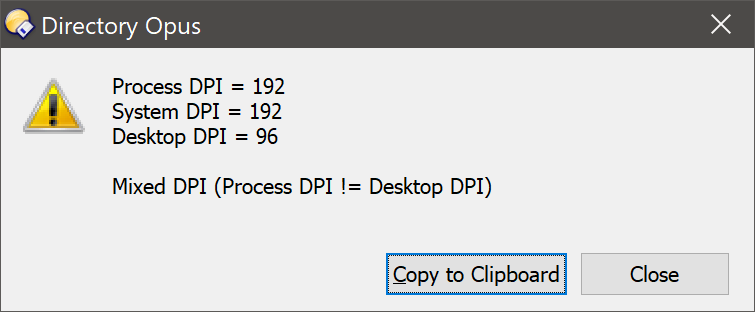

You should see something like this:

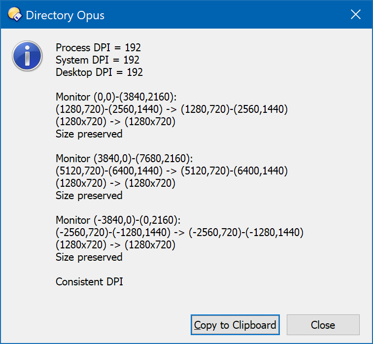

Or this:
Click the Copy to Clipboard button and paste the result into a reply and we should then be able to see what's happening.
