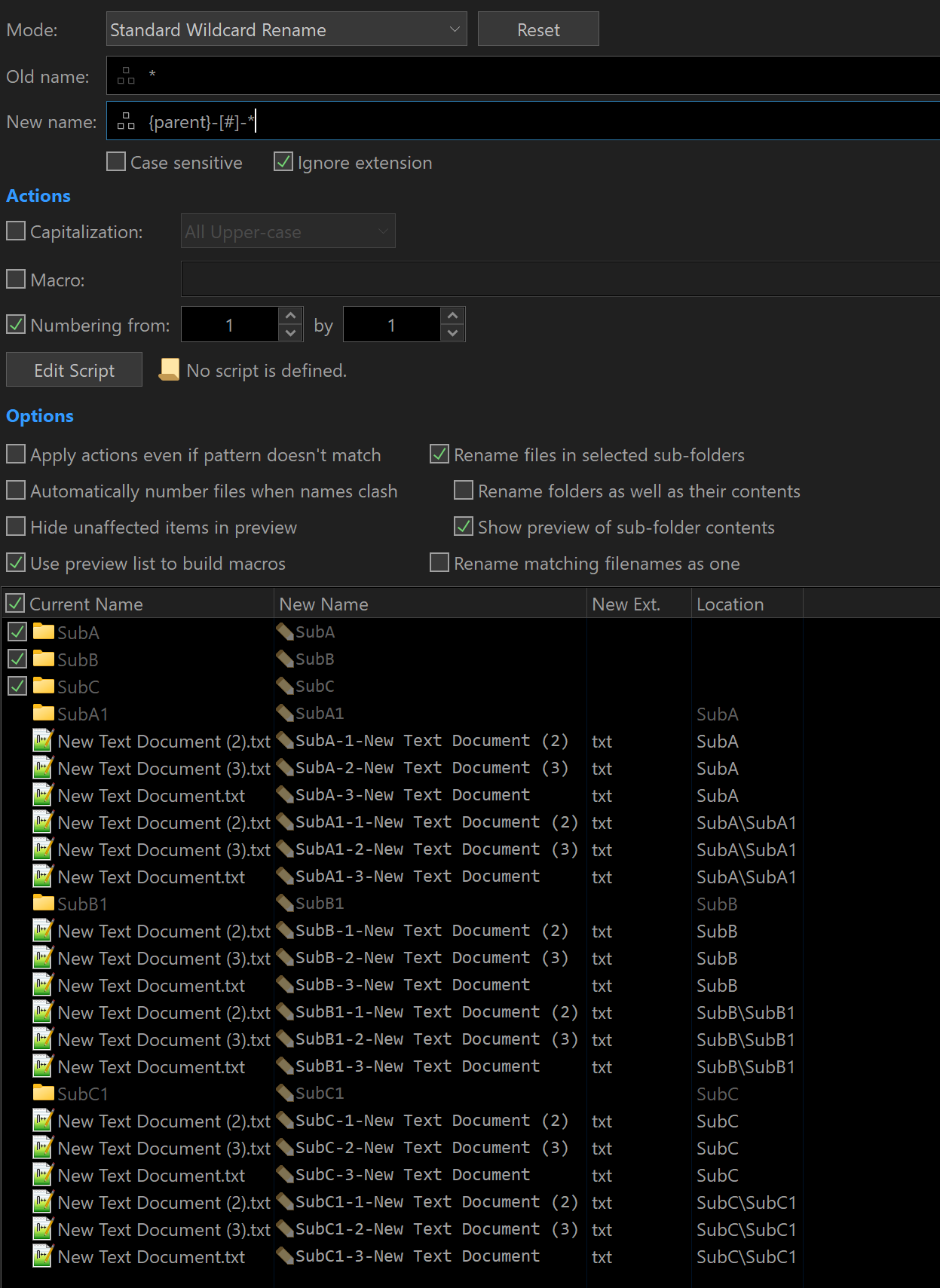

The rename tool can do this, no need for a script.
Rename PATTERN=* TO={parent}-[#]-* IGNOREEXT NUMBER=1 RECURSE
Subtle detail:
Note that the rename should be run on the folders, not the files themselves.
Usually it doesn’t matter but if you’re adding a counter it makes a difference. One way gives a count starting from 1 for each folder. The other would give a single count for all of the selected files, where the number would keep increasing instead of resetting to 1 each time the folder changes.
