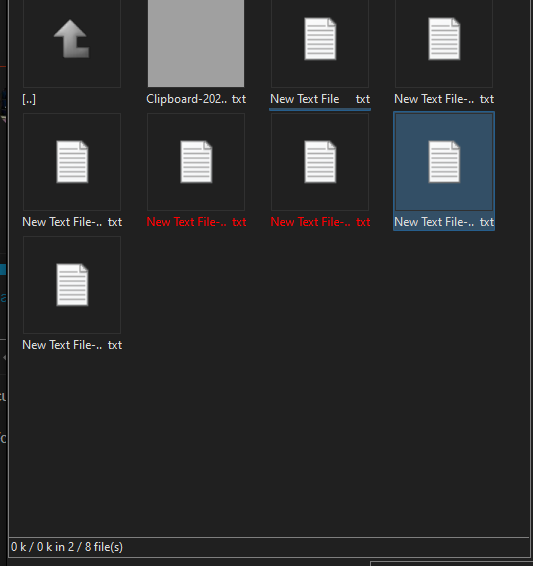

You can't, DOpus will select the item when it is focused.

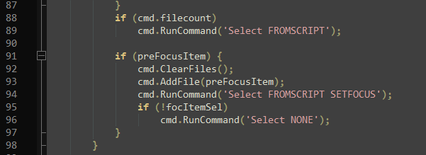

Thank you, but I'm not entirely sure what that script snippet is showing. If the behaviour I am after isn't possible then that's fine and I'll stop looking for a way to do it.
TC sets the label of the focused item to red when the spacebar is pressed, maybe you can do that with a script.
