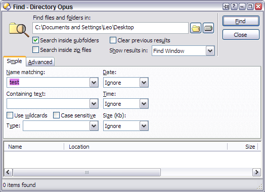

I've never seen it take over the screen. It sounds a lot like your output window is docked, which is the only time I know of when it will move other things around (because it becaomes a toolbar on the side of the screen). Just un-dock it and it won't anymore.
Just to confirm, my Find dialog looks like this:
For me, the problem occurs when you show the results in an output window, not the find window. Find window, a way to circumvent the problem, seems to work ok
cheers
Then your output window is probably docked. Undock it, problem solved. :slight_smile: You can also disable docking of the output window completely (described a few posts above).
