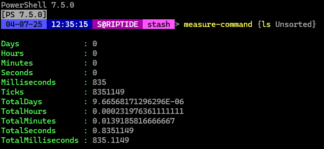

How fast can you list the directory from a command prompt? Or any other tools?
It takes less than a second to a ls command from powershell so cmd should be even faster, also I do not have access to such an option in Unraid it seems:

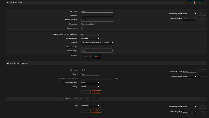

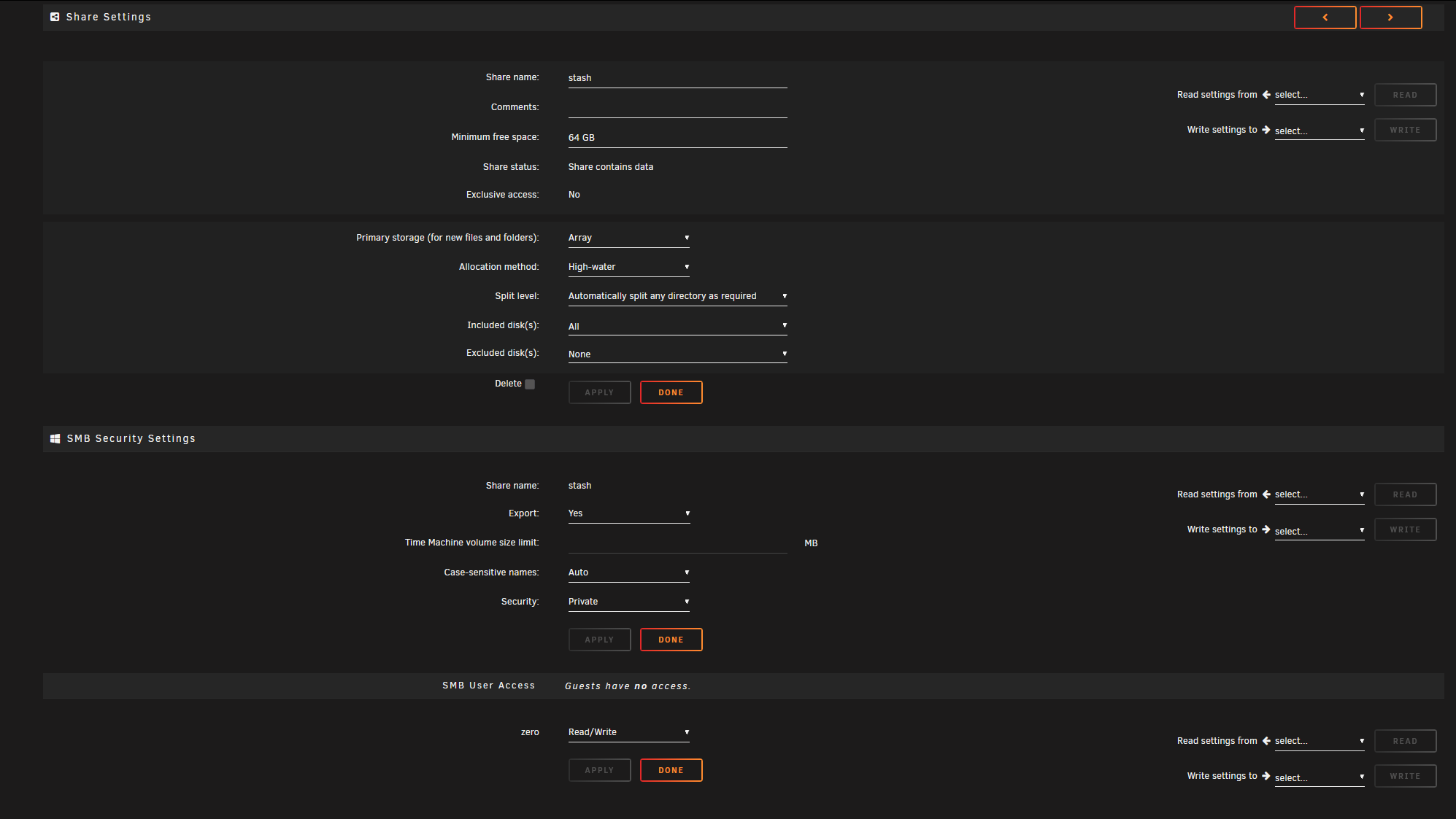

Ok so after experimenting for a while I took some time to find the issue but what improved it for me was:
-Enabling case-sensitive names on the share
-Disabling macOS interoperability in Unraid settings
-Disable support for extended attributes and handle it in dopus config
-Disable storage of DOS attributes
-Disable support for hardlinks
You were right and I apologize, turning these off in Unraid made it behave just like all the others.
It seems that all the options put together brings an improvement but others who have this issue can try to play around with this.
I think disabling hard links and extended attributes is what helps the most.
