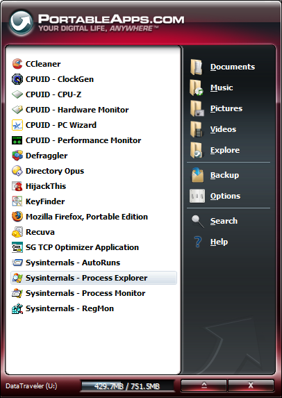

U:\ (USB drive root) | | Autorun.inf <--- Runs StartPortableApps.exe if AutoRun is enabled. | DOPUS.exe <--- Opus Exports this file here, I move it below | StartPortableApps.exe | +--DOPUS <--- Opus exports this folder here, I move it below | +--PortableApps | +--CCleaner +--ClockGen +--CPU-Z +--Defraggler +--Directory Opus | | DOPUS.exe <--- I move this file here from above | | | \--DOPUS <--- I move this folder here from above | +--FirefoxPortable +--HiJackThis +--HWMonitor +--KeyFinder +--PC Wizard +--PerfMonitor +--PortableApps.com +--Recuva +--Sysinternals Suite \--TCPOptimizer
I created a PortableApps User Command that contains an NT Command script (MS-DOS batch function), which moves everything for me. (In addition to Opus, it also does things like back up my local Firefox profile to FirefoxPortable).
For Opus, my script command deletes the previously moved Opus executable and folder, before moving the recently exported copy (generated by the Opus Backup & Restore Function) to my desired location.
For the curious, I move the Opus Folder so it is picked up by the Portable Apps Menu. But I could just as easily use Directory Opus as my USB application, by simply editing AutoRun.inf to launch DOPUS.EXE.
