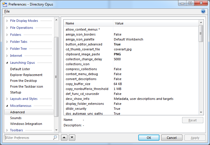

Here are the DOpus prefs:

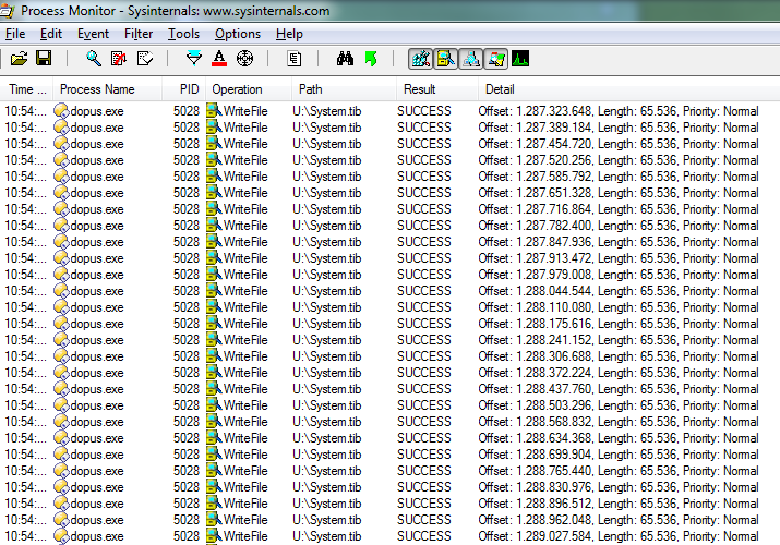

Copy using DOpus with enabled non-buffered-IO
-> Filesystem write cache is filled and system is occassionally freezing until USB-Stick stops blinking

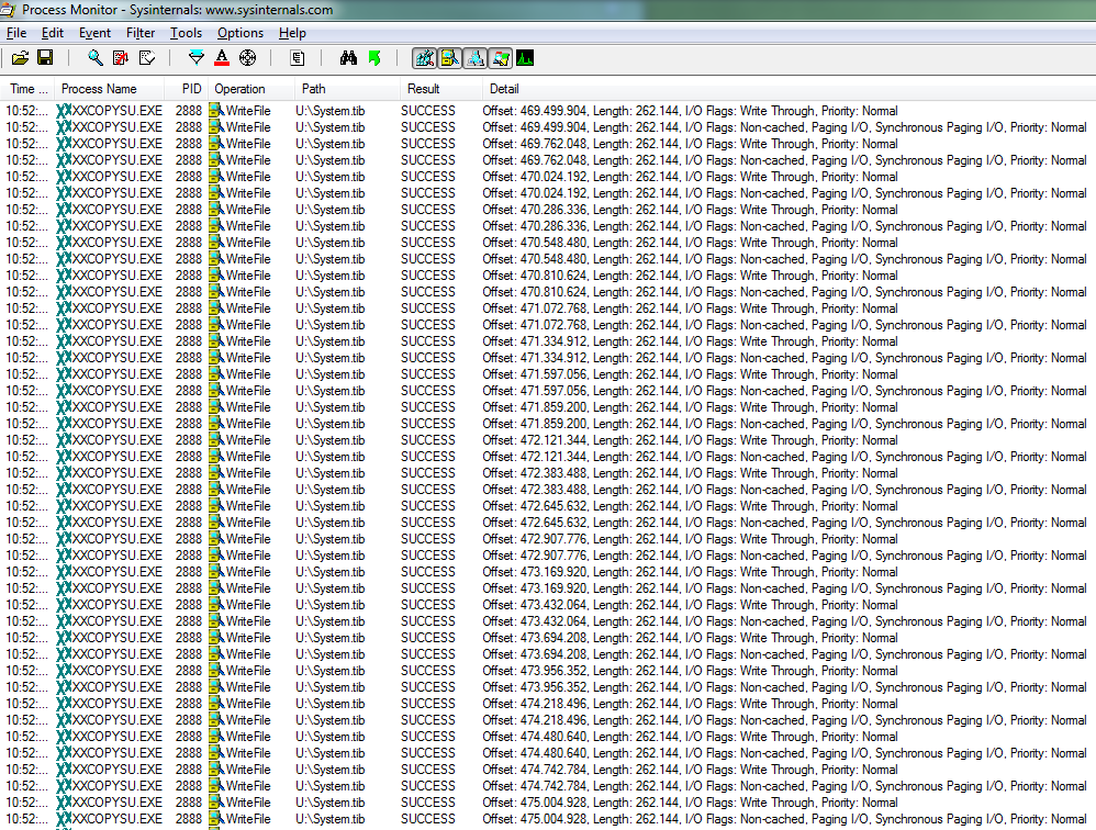

Copy using xxcopy with disabled write-caching (/ca0 parameter)
-> Copy took longer but no freezes at all (USB-Stick stops blinking when command returns)

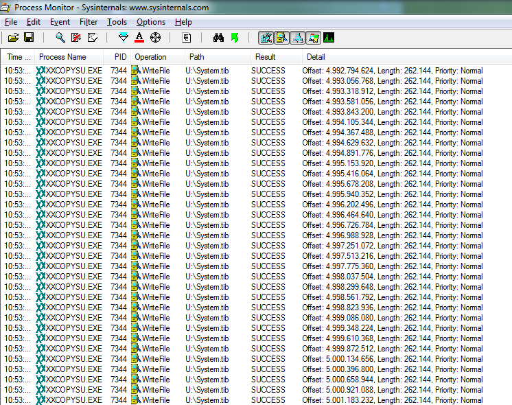

Copy using xxcopy with enabled write-caching (/ca7 parameter)
-> Filesystem write cache is fille and system is occassionally freezing until USB-Stick stops blinking

Direct comparison of the xxcopy unbuffered write and DOpus unbuffered write seems that xxcopy flags the write as synchronous write-through. And in this mode we can copy hundreds of gigabytes without any issues.
Here you see the difference:
