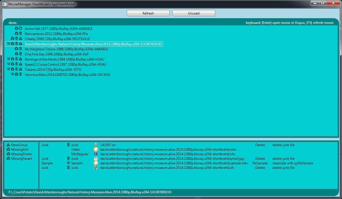

Come to think of it, I already have written a WPF app for exactly this about 5 years ago, I just cannot remember where I put it. All I could find was a lonely screenshot. :crazy_face:
It was(is) pretty powerfull, though. It could handle pretty much all the metadata files and any mess you can imagine. The only rule - movies need to be in individual folders.
Although, being me, if I'll find it, I'm pretty sure, I'm gonna start re-writing it in some shape or form.
Just look at that awesome green :slight_smile:
