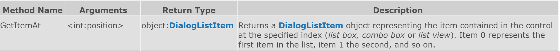

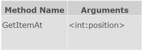

Let's look at the documentation for the Control object where we see this description of the GetItemAt method:
The GetItemAt method requires an argument, the position of the item you want to get:
This makes sense, since GetItemAt needs to know which item you want it to get, and you need some way to tell it.
