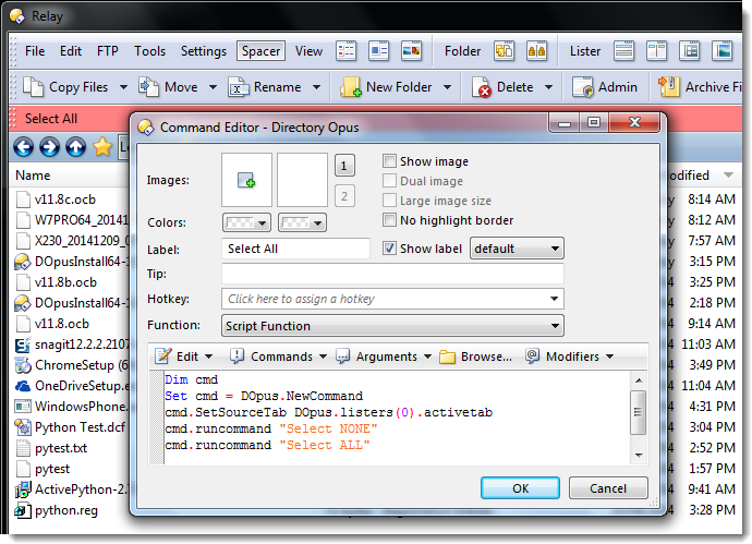

v11.8.2 Beta on Windows 7 64-bit. If I run the following simple test script against a tab where one or more files is selected, the end result is that no files are selected.
Dim cmd Set cmd = DOpus.NewCommand cmd.SetSourceTab DOpus.listers(0).activetab cmd.runcommand "Select NONE" cmd.runcommand "Select ALL"
The Select NONE statement is evidently being executed but not the Select ALL. Am I doing something wrong?
Regards, AB

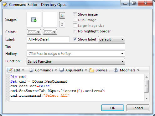

I switched things around as I couldn't see a need for an additional command object (scriptbutton):
Function OnClick(data)
        Set cmd=data.func.command
        cmd.SetSourceTab DOpus.listers(0).activetab 'Not really needed in a scriptbutton, but.
        cmd.deselect=False
End Function
The .deselect property does the same as @nodeselect in a regular command.
When testing in CLI the same works without wrapping it in a function if you replace "data.func.command" with "DOpus.NewCommand".

Thanks for the DOpus.listers.count fix. The original Select All problem is still there. I'll attach an OCB. It is almost vanilla but includes a toolbar called Test with a single "Select All" button that launches the command. After clicking the button, nothing is selected.
Regards, AB
