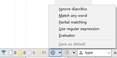

I can mostly confirm that this is a bug, that after I upgraded to 13.4 the quick filter function (when you type within the lister) will always default to use no option enabled:

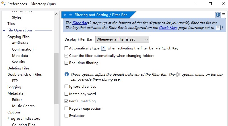

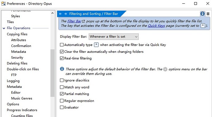

Even when settings has the correct defaults:
I've tried to reset a few things and nothing changed this. The wrong defaults applies to every lister I have. Changing defaults does not change this behavior.

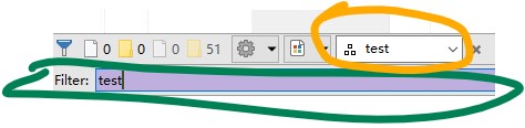

I tried to find how do I reset the Quick Filter toolbar, but I cannot find the detailed setting for it. But I think you are right, and my previous screenshot is actually wrong. The actual view is this:
Previously when I tried to take a screenshot, the green circled filter box disappeared so it is not showing. This field shows up only when I am typing, and has the issue. When I type in the orange circled box, it behaves as it is configured.
Gathering what I understand now, I assume there's two issues:
When typing for filter (assuming this is the Quick Filter box?), the filter no longer does a partial match.
When typing for filter, the gear icon button menu shows no option chosen. Which is probably correct but a bit confusing (that I thought this is the filter option).
The bottom bar in your screenshot is the FAYT in filter mode. Normally that wouldn't come up as the filter bar is set to respond to the * key, and find mode is the default for the FAYT. You may have changed the settings though.
FAYT Filter Mode is configured via Preferences / Filtering and Sorting / Find-As-You-Type / Filter Mode
Which mode is the default is configured via Preferences / Filtering and Sorting / Quick Keys
These are the default settings (filter mode has no key, filter bar has * as its key, and Find is set as the default):
Thanks Jon it looks like that's the FAYT setting. I think I can change the setting to make it behave right.
