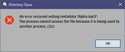

Just having the files selected is enough to error out. It happens with trying to modify the metadata with the Dopus metadata pane too.
Error

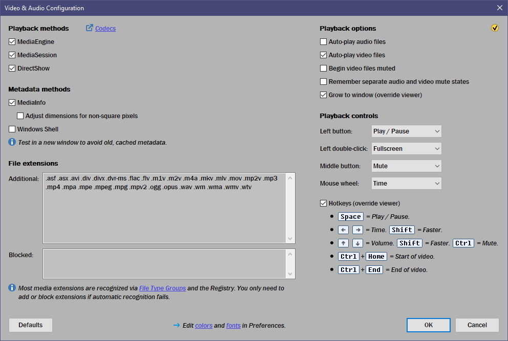

I've turned off autoplay. I use custom arrow keys to play music files.
Right > play, Left > stop, Up/Down > prev/next file.
Here's my settings:

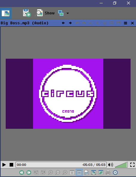

The album art shows in the preview pane:

I thought that the temp file when writing to the file was the solution. I will double check my settings on that.
That's still playing the file, it's just paused at the start.
We should be able to improve this in the future, but for now you'll need to close the preview pane to stop the files being locked open for reading.
