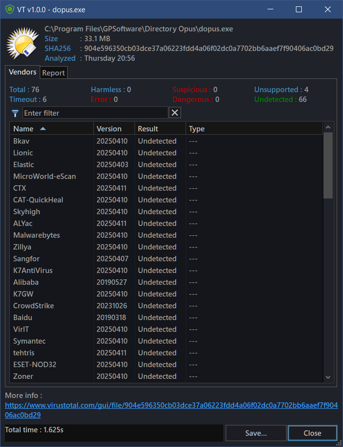

VirusTotal Command
VT is a script add-in command for Directory Opus, that allows users to scan files using the VirusTotal API.
Key Features:
  • Automated process, including file upload if they do not exist in the database.
  • Comprehensive report presented in an easy-to-use and understand interface.
  • Ability to write reports to disk/clipboard as plain text or JSON formatted.

In the Script Management window, select VT and click in the Edit button.
  • log level : Logging level to be displayed.
    • OFF to show only errors.
    • DEBUG to show all messages.
    • STANDARD to show only the most relevant information.
    • WARNING to show messages that needs your attention.
  • max timeout : Maximum time in seconds to wait for a connection.
  • force file report after analysis : Set to True to retrieve a full file object after you get an analysis report. This will result in a extra request per file.
  • max threads : Maximum number of files to process simultaneously when using the NOGUI argument.
  • allow multiple instances : Allow run multiples instances (when NOGUI is not used).

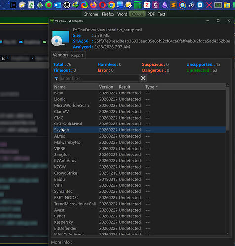

Awesome script but is there any easy way to resize the dialog? The bottom part is always off screen for me.
v1.5.1 (Mar 07, 2026):
  • Added some minor changes prior to v2.0 migration.
NOTE: v2.0 will bring many improvements/fixes, including the switch to a script package, so Opus will treat the new version as if it were a new one, thus losing its configuration. To workaround that and avoid having to enter your API key again, it's recommended to update to v2.0 only from v1.5.1.
What's your current screen resolution / screen scale %? I'm not really sure why that could be happening to you, tbh.
You can try maximizing the dialog.
I guess I can make the dialog a bit smaller.
My resolution is 200% as my monitor is quite large, but i also have a floating toolbar up top.
Maximizing does not resolve the issue. I have tried resizing it myself in resources, but had limited success.

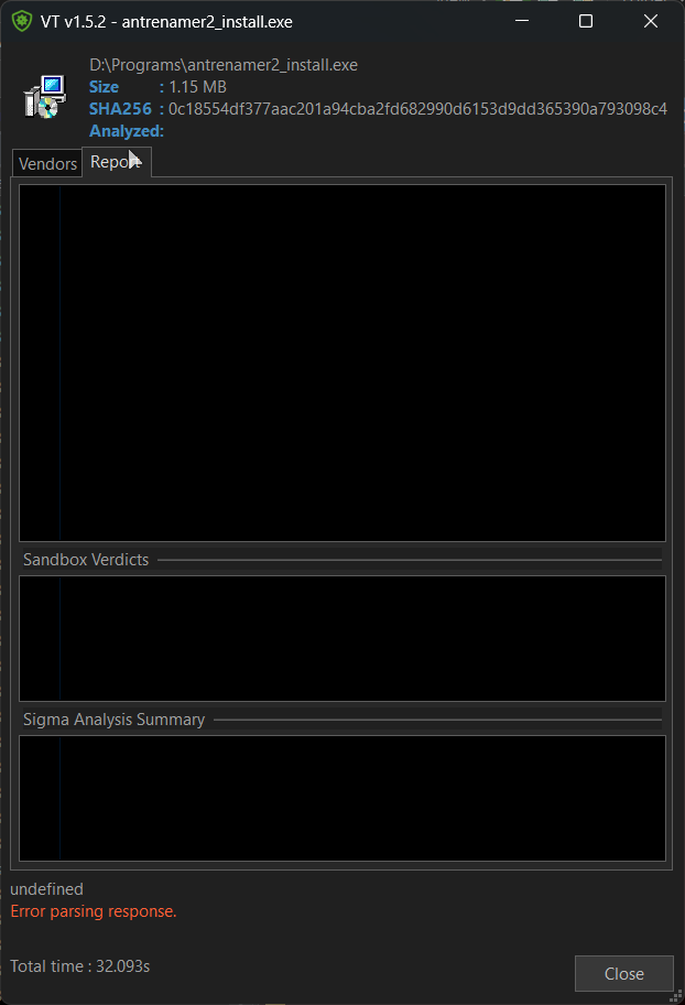

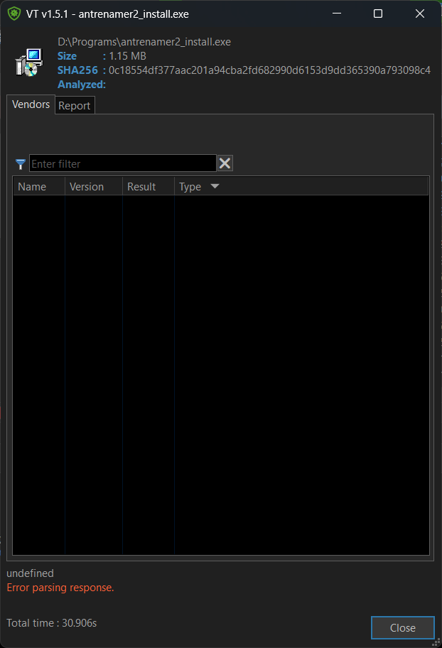

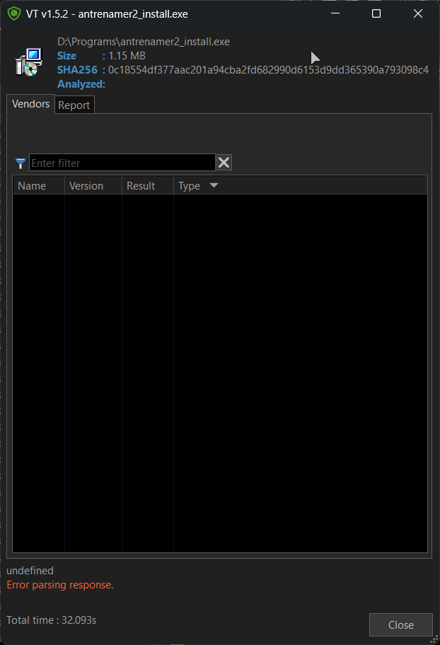

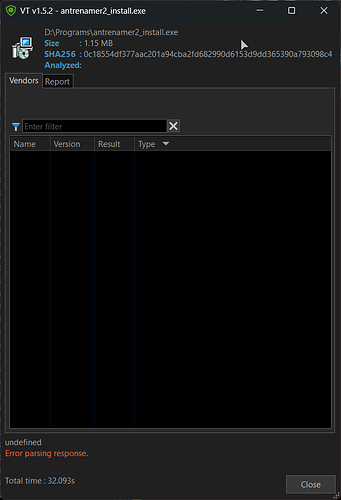

Summary
8/25/2026 9:47 PM VT: INFO => =========== VT v1.5.1 ===========
8/25/2026 9:47 PM VT: DEBUG => cmdline : VT
8/25/2026 9:47 PM VT: DEBUG => NOGUI :
8/25/2026 9:47 PM VT: DEBUG => AUTOUPLOAD : false
8/25/2026 9:47 PM VT: INFO => FILE : D:\Programs\antrenamer2_install.exe:object.Item
8/25/2026 9:47 PM VT: INFO => D:\Programs\antrenamer2_install.exe : size=1.15 MB
8/25/2026 9:47 PM VT: INFO => max_timeout : 30s
8/25/2026 9:47 PM VT: INFO => MAX THREADS : 1
8/25/2026 9:47 PM VT: DEBUG => Sending hash : GetHash "D:\Programs\antrenamer2_install.exe" HASH=sha256
8/25/2026 9:47 PM VT: INFO => Hashing D:\Programs\antrenamer2_install.exe...
8/25/2026 9:47 PM VT: INFO => Hashing finished for D:\Programs\antrenamer2_install.exe...
8/25/2026 9:48 PM VT: DEBUG => => event : custom ; control : D:\Programs\antrenamer2_install.exe
8/25/2026 9:48 PM VT: INFO => D:\Programs\antrenamer2_install.exe : SHA256=0c18554df377aac201a94cba2fd682990d6153d9dd365390a793098c403a496c
8/25/2026 9:48 PM VT: DEBUG => D:\Programs\antrenamer2_install.exe => Sending request "1" for get_report to https://www.virustotal.com/api/v3/files/HIDDEN_NUMBER
8/25/2026 9:48 PM VT: DEBUG => D:\Programs\antrenamer2_install.exe => Request "1" sent for get_report
8/25/2026 9:48 PM VT: DEBUG => => event : http ; control : 1 ; value : error
8/25/2026 9:48 PM VT: DEBUG => Request 1 is complete
8/25/2026 9:48 PM VT: DEBUG => Timer request_1
8/25/2026 9:48 PM VT: DEBUG => Attempt to kill request 1 for D:\Programs\antrenamer2_install.exe
8/25/2026 9:48 PM VT: DEBUG => Stop processing D:\Programs\antrenamer2_install.exe(object.Item)
8/25/2026 9:48 PM VT: DEBUG => D:\Programs\antrenamer2_install.exe : Setting info...
8/25/2026 9:48 PM VT: DEBUG => processed_files=1 : total_files=1
8/25/2026 9:48 PM VT: DEBUG => All files has been processed!
Looks like you're either blocking Opus from connecting to the internet, or you've set an invalid API key, because the connection is failing right from the start.
BTW v2 is more verbose for these kinds of issues. I thought I'd uploaded it a while ago, but I was wrong :melting_face:; so thanks for pointing that out.
well are you going to upload it ?
Yes, but I need to test it thoroughly first. I remember that was the reason I hadn't uploaded it yet, since I basically rebuilt the original from scratch and added new things on top of it.
