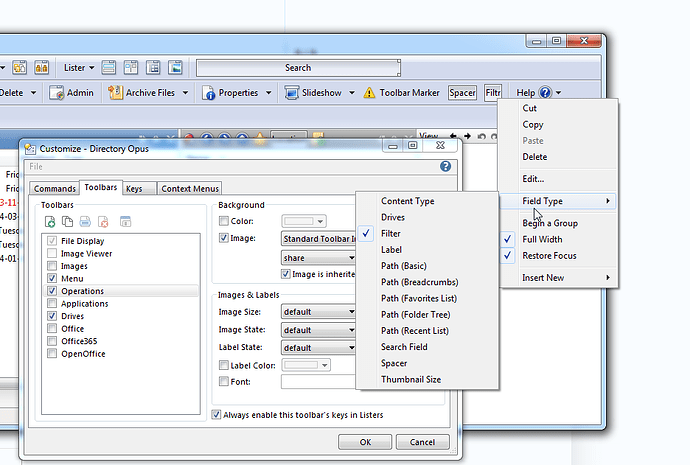

Element of toolbar that is type of Label and has Field Type of Filter.
