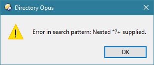

What is wrong with this regex? (Nested *?+ supplied)
The rename script preview shows 'no errors' and in preview files are renamed correctly.
At [Apply] I get the above 'Nested' error.

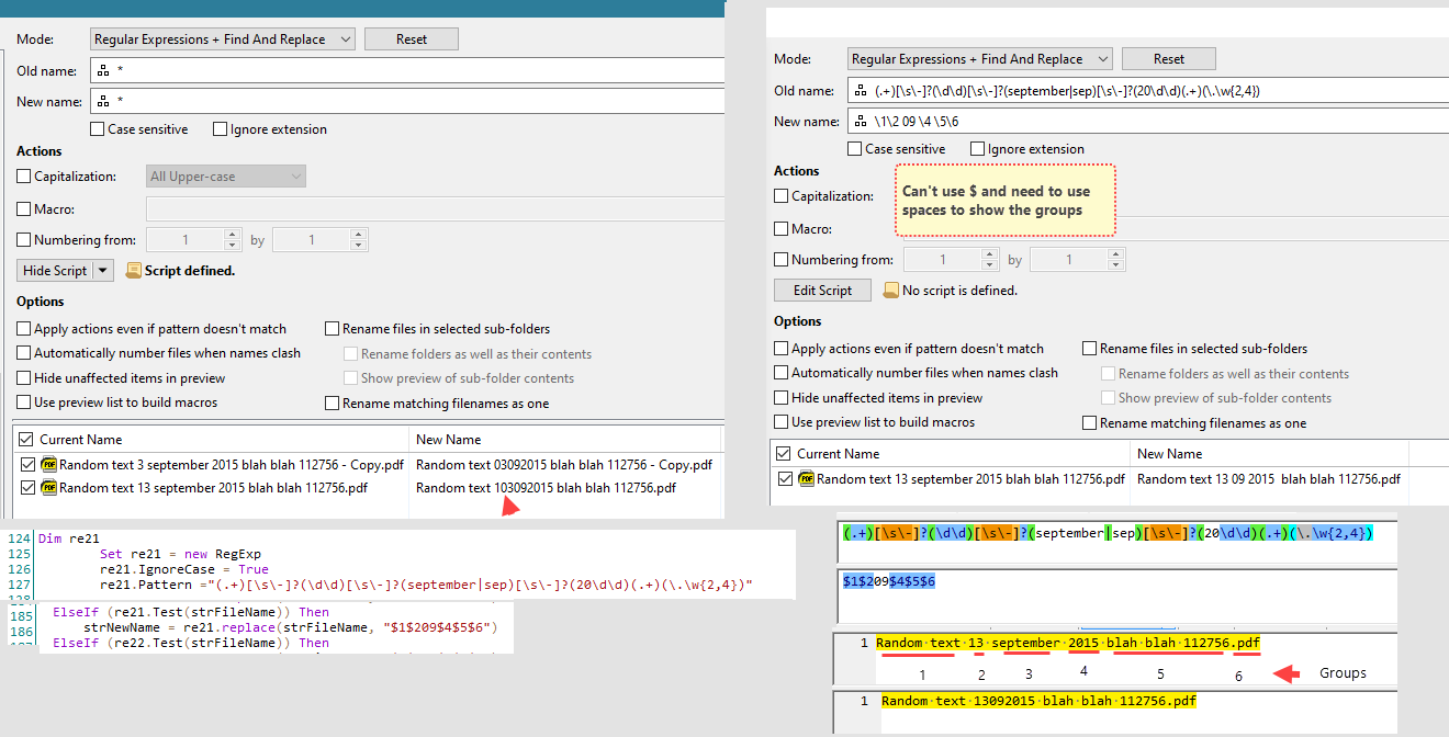

Took a while - busy puzzling on the following issue (best explained with a screenshot)
I use a regex tester, right hand bottom corner on the screenshot, the regex and the replace.
Marked the groups.
Top you see a single regex find and replace. I need to make use of \ character.
Added spaces so as to mark the groups. (can't use the $ character)
Left is same thing but in a script.
In case the day is a single digit (3 september) then the results are okay
In case of a double digit a 0 is added: 13 september 2015 > 103092015
Am very far from being an expert, so I have no idea how to fix this, or better: i can't find the error...
any idea?
Thanks again.

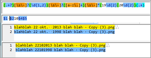

var genericRE = /^(.+?)[\s\-]?(\d{1,2})[\s\-]?([a-z]+)[\s\-]?(20[012]\d)(.+)$/i;
to
var genericRE = /^(.+?)[\s\-]?(\d{1,2})[\s\-]?([a-z\.]+)[\s\-]?(20[012]\d)(.+)$/i;
And then add entries such as nov. in the appropriate arrays.

Made a change:
var genericRE = /^(.+?)[\s\-]?(\d{1,2})[\s\-]?([a-z\.]+)[\s\-]*?(20[012]\d)(.+)$/i;
added '*' before ?(20[012]\d)

To cover pre 2000 years regex might be changed into
var genericRE = /^(.+?)[\s\-]?(\d{1,2})[\s\-]?([a-z\.]+)[\s\-]*(19\d{2}|20\d{2})(.+)$/i;
