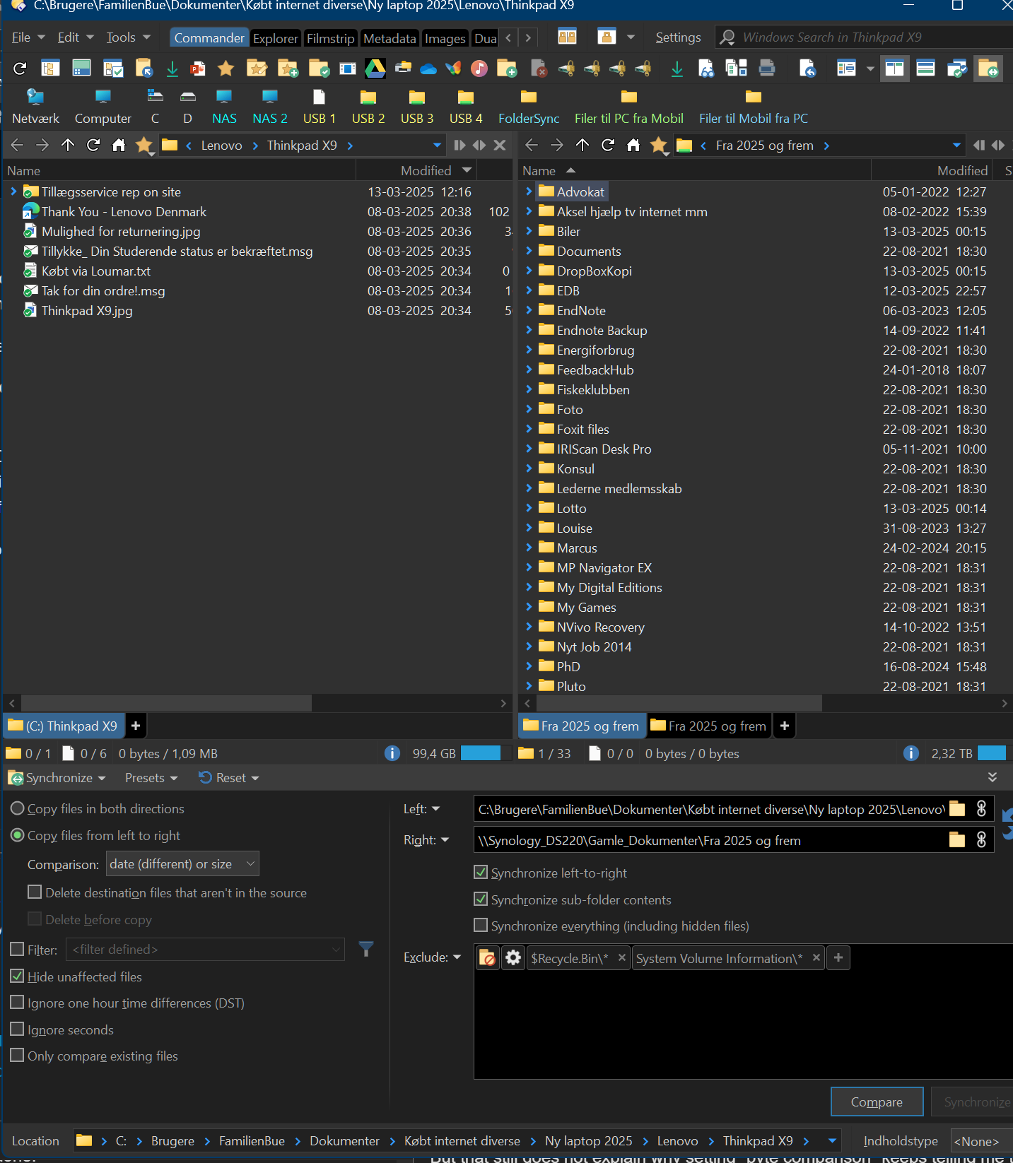

sync panel setting herem also shows things to sync:
We need examples, else we're left guessing. The byte comparison option isn't selected in your screenshot, so that can't be the config that was used. We also can't see any examples of files that are identical but that it still wants to sync.
