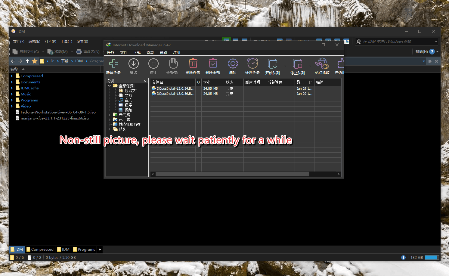

When opening a folder through idm, opus has a long wait to open the corresponding file
Honeycam 2024-01-29 16-17-53
Honeycam 2024-01-29 16-20-31
This operation is normal in opus 12.33
Problem opus version: 13.1
idm version: 6.42
The display mode is enhanced mode, or in detailed mode, check the option to select the first file in the display bar.
Demonstrations of two scenarios are provided in the attachment:
  1. Demo of problematic opus13.1
  2. Demo of opus12.33 without problems
Non-still picture, please wait patiently for a while

This is not the case. If you download any file through idm and open the folder through idm, it will take a while for the associated opus to display the status of the corresponding selected file.
Please be patient and watch this demo, it will last about 1 minute.

Okay, I just want to confirm whether the problem exists. The feedback information is not the problem scenario I described, so I sent some information to supplement the description.
