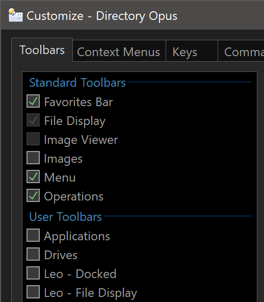

  • Default hotkeys come from these toolbars, in the Standard Toolbars part of the list:
  • If you're using completely custom versions of those (and haven't just turned them off), create new copies. (Select or right-click each and click Duplicate.)
    Those will be the toolbars you use and modify going forward.
  • Reset anything under Standard Toolbars that you want back to factory defaults. (Select or right-click each, and use the factory-reset option.)
  • While there, select those toolbars and, on the right, make sure Always enable this toolbar's hotkeys in Listers is turned on.
