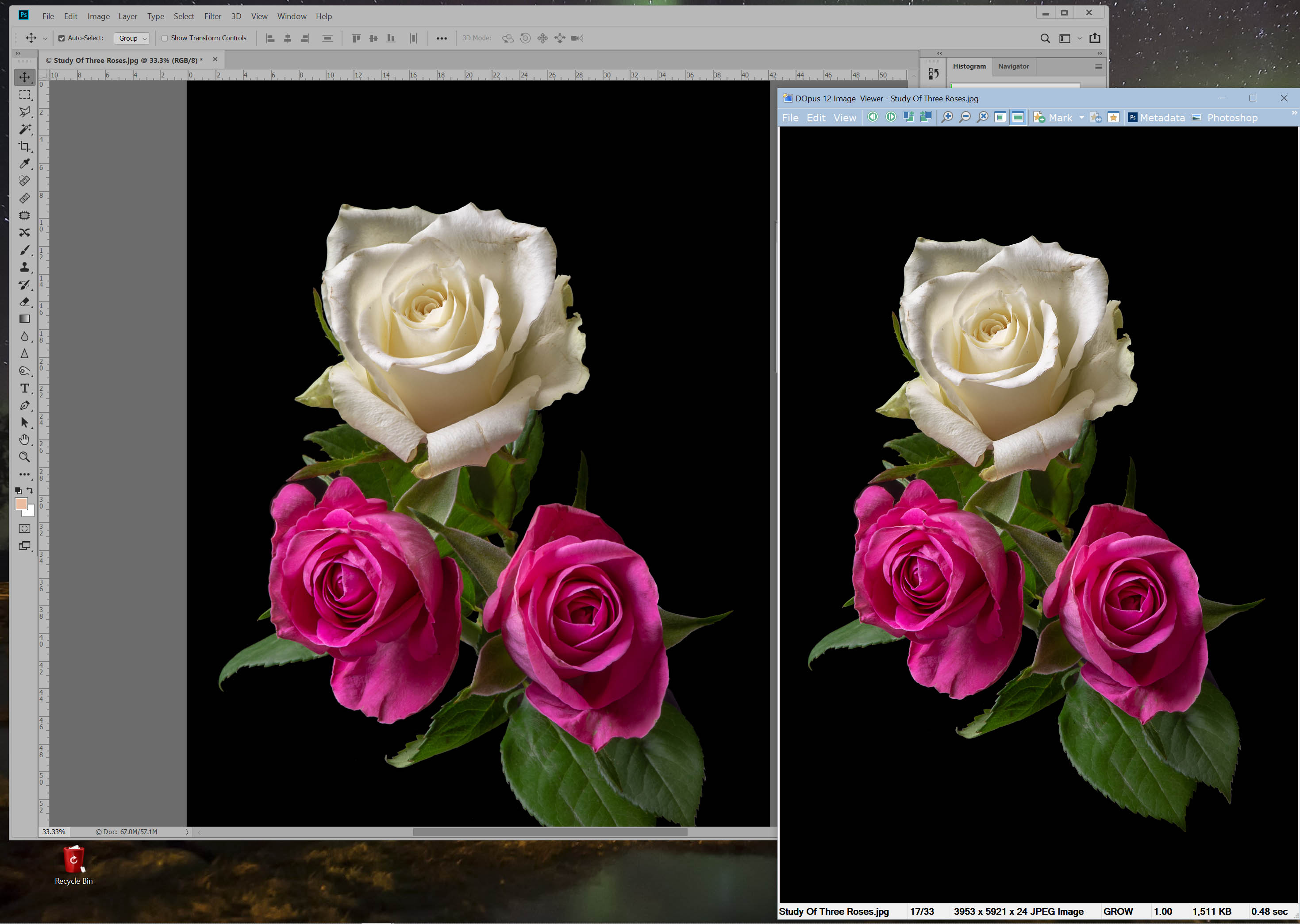

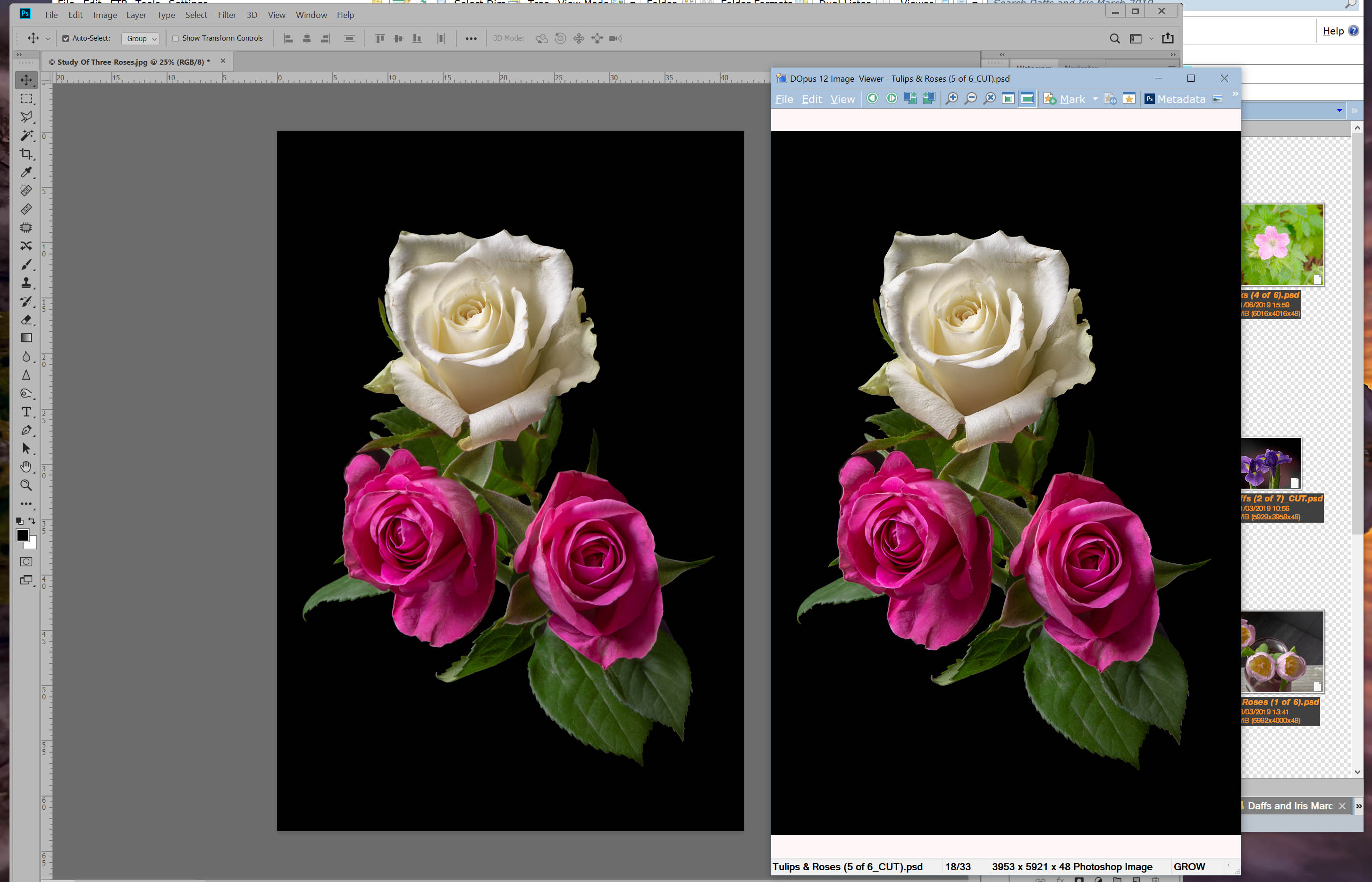

I have a monitor with a hardware set color profile. From the profile creation software I have made an ICC profile from the hardware settings.
I have applied that profile to the Opus picture viewer and to Adobe Photoshop CC. The same picture viewed in each application looks identical, and, as the monitor is hardware calibrated, the thumbs match, too.
Not sure what your problem could be, I am afraid, but it works a treat here.

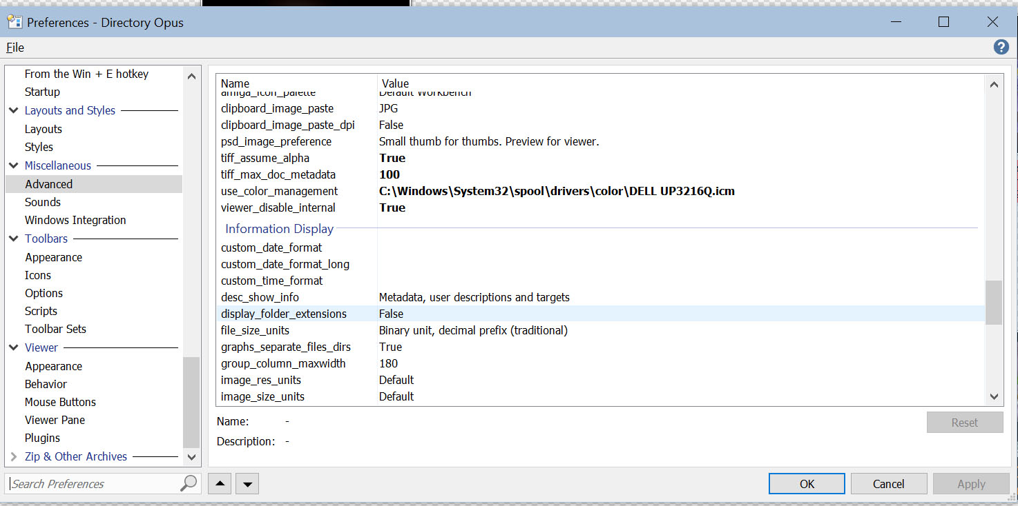

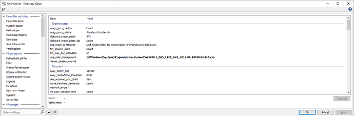

You need an ICC profile (i.e. .ICC or .ICM file usually), and you need to tell Opus to use it. It won't pick up the profile from Windows automatically.
Sounds like that hasn't been done?
It's set via Preferences / Miscellaneous / Advanced [Image Formats]: use_color_management which is off by default.
It really does not matter what profile you use as long as it is the same in the apps you are using. These examples are using sRGB.
AS I proof and print many images I want WYSIWYG between my monitor and printer, that is why I use my display profile.

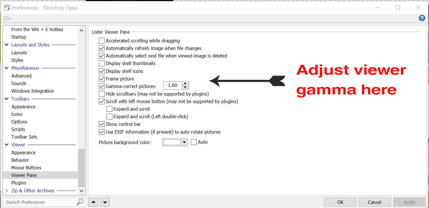

BYW you may need to do some adjustments to the Opus viewer using the gamma setting to get the best match.

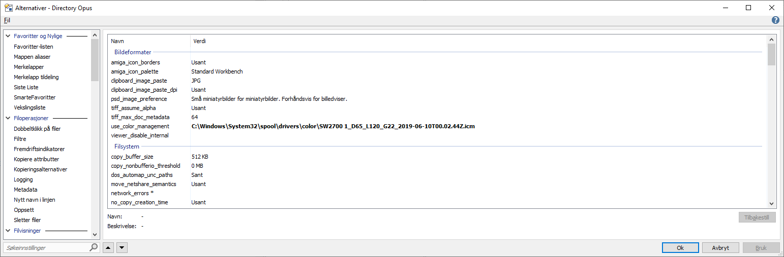

I have selected the Windows monitor ICC profile I made with i1 Display Pro.

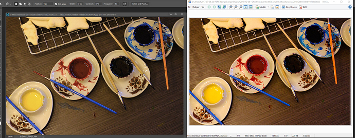

This is very strange. I hardware calibrate my monitor and the image I see in Photoshop are great while the image in DOpus are extremely oversaturated and contrasty.
Could you please show with screenshots where you place your monitor profile and do the gamma correction?
I never experienced images in both apps like you show above. Ever.
I'm not sure how well you're going to see my problem, but the oversaturation doesn't go away with gamma correction.
I wonder whats happening..

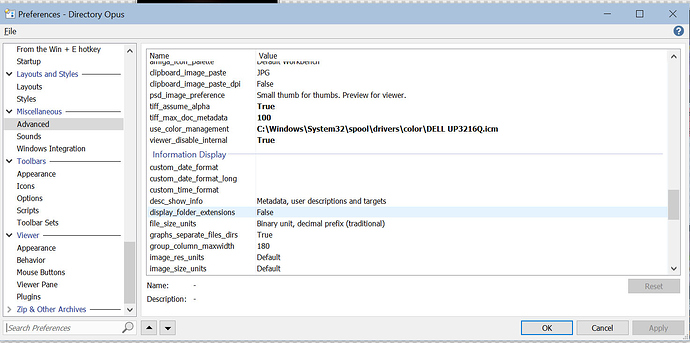

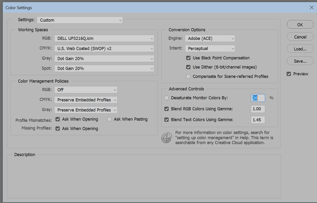

My setup is achieved thus:
Photoshop
Opus
Opus Viewer
Thumbnail setup

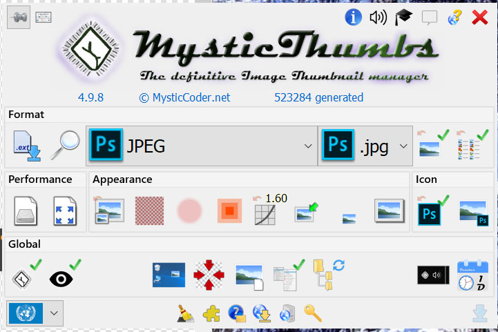

I enclose the Mystic Coder set-up simply for completeness. I thumbnail with this program as it is the only really reliable thumbnailer I have found that will give me transparent backgrounds to eps and pdf files. So this probably will not apply to you.

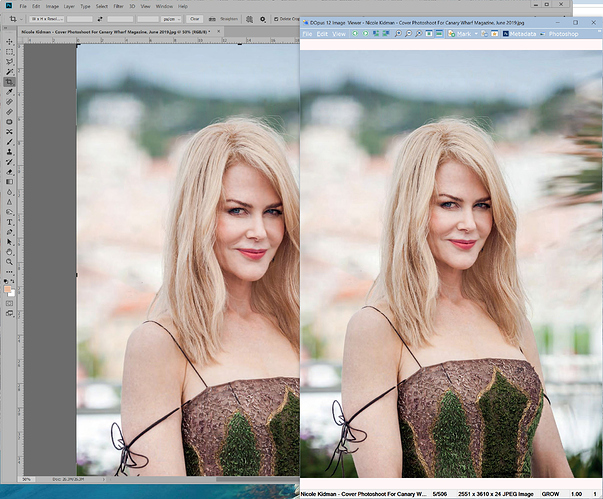

The result
Hope this is of some help.
Thanks for the screenshot, I'll review all the settings later. Yes I use Gregory McBeth charts/colorchecker
Just a small note, your first screenshot where you put monitor color ICM. Why did you put your device profile here, I've learned from Xrite and colorgrups on internet that you should never use device profile as working space, that this is where you put file colorspace like sRGB and AdobeRGB. If I put mine screen profile there I will get a big difference from Lightroom to Photoshop.
Ref point nr 3. https://www.color-management-guide.com/color-settings-photoshop.html
CAUTION ! DO NOT CLICK ON THIS PROFILE, BECAUSE, THEN PHOTOSHOP WILL USE THIS PROFILE AS RGB COLOUR SPACE BY FAULT

Interesting article, and contrary to what I was taught - not that that is necessarily right, of course, especially as it was many years ago in the infancy of Photoshop - version 2 on a Mac to be precise.
I have decided to follow the advice of the article and move to sRGB as a colour space.
The only extra work I had to do was to play with the gamma on the Opus picture viewer.
This is t he result with the sRGB colour space on my system.
Which I guess just goes to prove that modern colour management is a wonderful thing.
