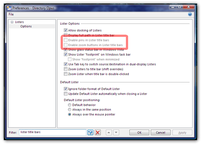

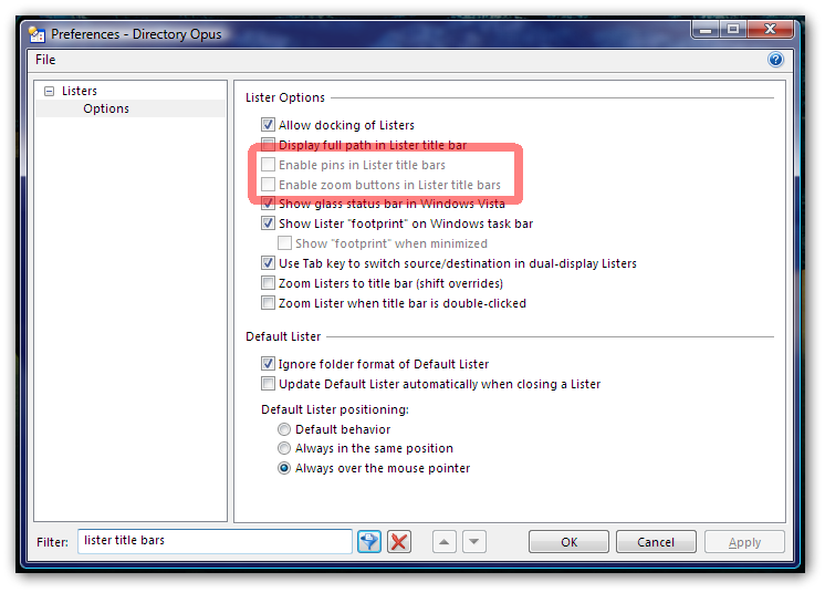

Maybe the buttons are turned off? See below:
If WindowBlinds compatibility is enabled in Opus (it will be by default if WindowBlinds is installed) then the buttons are disabled.
That did the trick...
