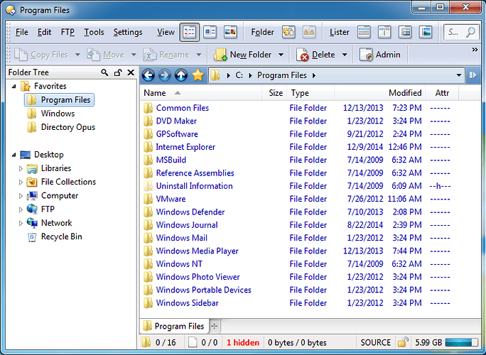

In Windows Explorer you can drag and drop a folder to the favorites category at the top of the folder view. Scrolling to the top of the folder tree and picking a "favorite" is much easier and intutitive than have to click on the favorite drop down and searching there. Is there an equivalent WE capability in Dopus such that a folder can be drug to the folder tree frame?
Turn on Preferences / Folder Tree / Contents: Favorites.
Folders can be dragged to the top-level Favorites item itself.
I did have that box checked but unchecked and re-checked to make sure and still don't see favorites in the folder tree. I do have a button on a toolbar with a pull down for favorites, but I was hoping to find it in the folder tree itself.
What is Preferences / Folder Tree / Options: Start Folder Tree at... set to? Make sure it is set to Desktop.
It is set to Desktop.
What does your tree look like; can you post a screenshot?
Here's an example showing the favorites branch in the tree:
