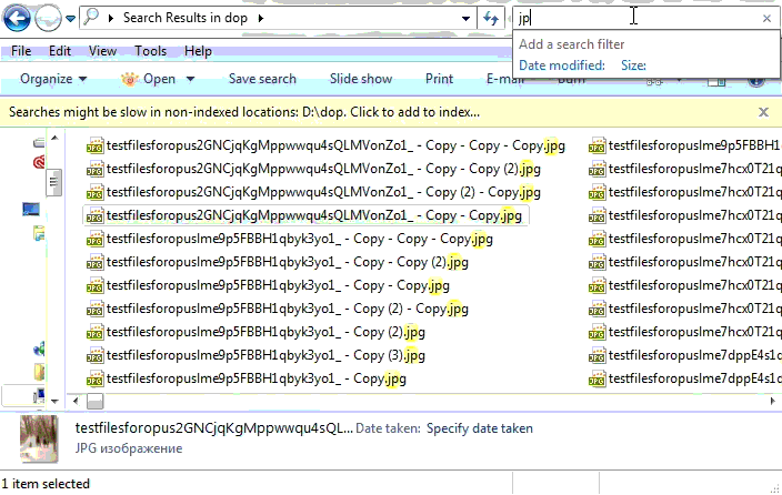

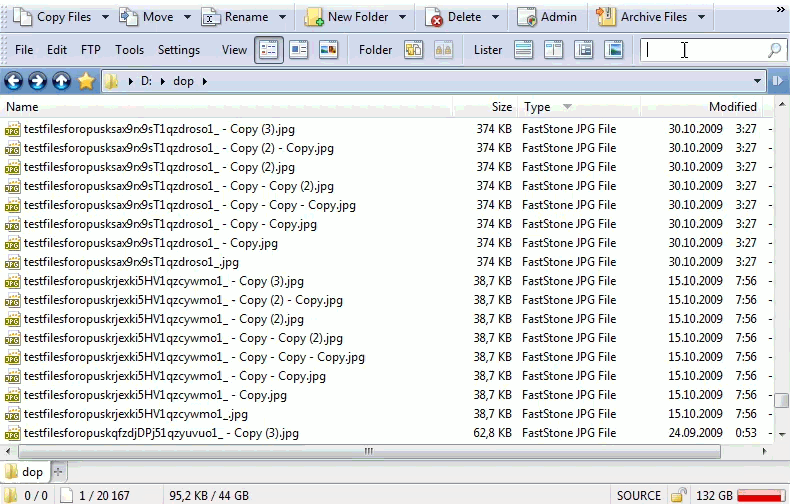

I encountered a strange behavior of built-in "windows search". It looks like it is not updating search results according to the characters typed in, at least not always. The problem usually occurs when I am trying to search through directories that contain large number of files, e.g. >~10000. I've made some gifs to show it, I will post them below.
Directory Opus "windows search".
Explorer native "windows search".
As you can see, I am trying to find all files containing "jpb" in their name in the corresponding folder. As soon as I type additional characters, search results update in both Explorer and Directory Opus, but Directory Opus leaves some results from previous search scope, not narrowing it like it should. This leads to a huge amount of non-relevant data in the search listing. You can type additionally "1" or any other character, like I did in the gif, wait for search to end, and then delete it, after that the search results seem to be correct.

When I first encountered the issue I thought about file contents too, that is why I tried adding extra character to the search query and than deleting it, to prove that DOpus returns different search results with the same search query, or in other words that search results depend on the way you enter search query and not on the search query itself.
Here is another gif, though this effect was already shown in the first picture in my previous post.
That's why I think that it is a bug, it's like Opus passes the query to WS correctly but updates the answer from it incorrectly.
I also tried filename:jpb and it returns non-relevant search results too.
