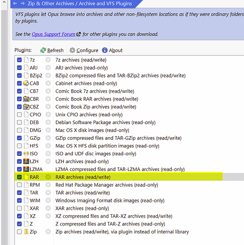

I have WinRAR 7.0 x64 installed on my Windows 11 system. When I tray to add a file to an existing .RAR or move a file from an existing .RAR or delete a file from an existing .RAR file I get this message:
My preferences are set as:
Not sure how to fix this. I have no problems doing the same from WinRAR itself.

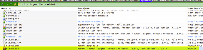

If you go to C:\Program Files\WinRAR and turn on the Description column, which version does it report for WinRAR.exe?
Try installing the latest version, maybe. 7.01 definitely works for me. I don't know if I ever tried with 7.0.
Same thing Leo...
Anything else I could look for?
Found the problem. WinRAR.exe was set to run as Admin. All is good now.
