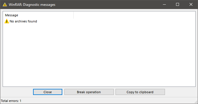

WinRAR "No Archives Found" with custom extraction button

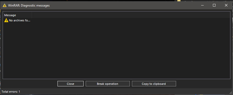

SUCCESS OK I deleted the last line of code like you said, and the archive extrracted itself into the self named folder, but did not move into it. No error window, no nothing!
I can see why you are confused about this. I copy and pasted this image from the first post where I showed the intial error window. I did not copy this from it actually happening at that moment when I made the post (i.e. while I was messing with the test archive) I'm sorry for the confusion.

I dont want to irritate you all on the board, but I wanted to try screwing around with various things for a while to see if I could understand what was causing my problems with WinRAR and extracting files from compressed archives, but I still can't figure out what the hell the problem is.
For anyone that wasn't around for my last go around, one of my most beloved functions I have been able to incorporate into DOpus was the option on my right click context menu for any compressed archive to extract the archive into a folder named using the archive's name, and then move the archive file itself into said folder. Out of the blue one day, WinRAR began giving me sh*t by popping up a window when I would use this function that's titled "Winrar diagnostic messages" and it would have nothing other than the phrase "no archives found" in the window. Now heres the weird part - everything still functions properly. The archive is extracted into a new folder that is named using that archive's name, and the archive file itself is moved into said folder. But The damn diagnostic window message continues to pop up!
I have tried so many permutations of this issue to figure out where the issue lies and I'm still just not sure. I had a hunch for a while that it may have to do with Default program settings, and maybe my defaults were screwed up somehow. Nope. Maybe WinRAR is corrupted. Reinstalled, reinstalled again using new download of program file. Nope. Maybe EVERY SINGLE ARCHIVE I HAVE ON MY COMPUTER IS CORRUPTED. Tested every archive I use with Winrar itself and 7zip that if I am simply extracting the archive to a folder named from the archive, no issues arise. Maybe I had a virus? Nope. Maybe DOpus install is corrupted? Nope, reinstalled and same behavior. I've skowered the internet for help with this and the only thing I find pertaining to this diagnostic message is 1000 youtube videos that claim to have the answer to the problem until you open the video and they ALL tell you to use 7zip instead of WinRAR. Gee, thanks. I've tried different ways of writing the script, using the CREATEFOLDER version that was recommended to me, and then the original MOVE version. Same effect. I tried using unRAR.exe instead of WinRAR.exe. Nope.
The error seems to be dealing with moving the file into the directory, as the decompressing feature works without error using the same means (using a script through DOPus, not through WinRAR program interface).
Does anyone have any recommendations ? Please? Thanks for any help.

and it causes this:
Please dont insinuate I'm stupid. Please tell me where I am so clearly going wrong here.
