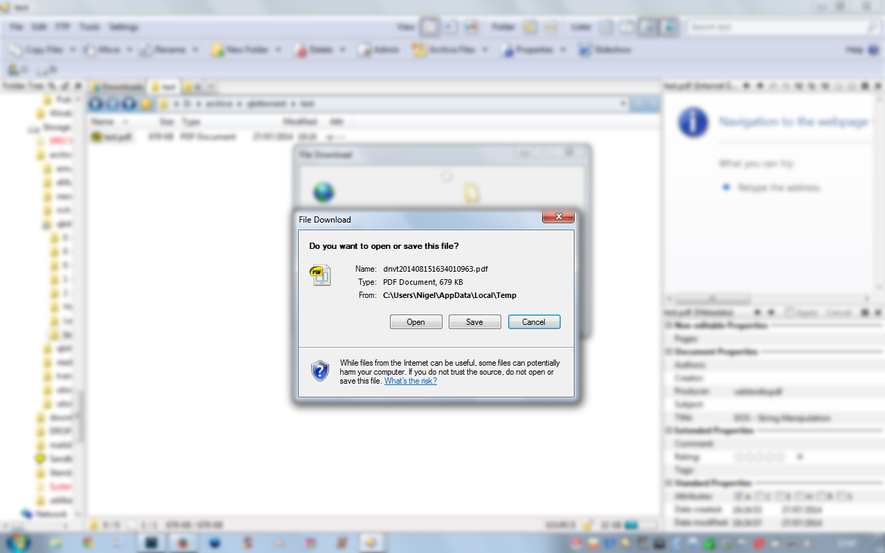

new user so probably my mistake, but this is a weird one. Yesterday I turned on the viewer pane and metadata pane for the first time, and I thought great - just the job for the photos etc. But when I click on any pdf file I get this weird message about a file I know nothing about.
Hopefully you can see the attempt to download a pdf file which I have not initiated nor is the name known to me. I get out of it by pressing cancel.
If I deselect the viewer pane this does not happen.
So until yesterday I was using dopus without any major changes to the configuration, except for adding the odd column. Of course now I've seen the viewer pane I really want to keep it open all the time because it is so useful.
my pdf software is sumatra...
How can I fix this?
I get this when I screw up the Viewer Plugins.
Go see there what is capturing PDF files. I'm a user of QuickView Plus, so can't really provide much more help than that.
PS You may have to change the order in which the plugins appear.

So to try to answer my own question. On the viewer plugins page I can select the ActiveX line and I can choose About or Configure and Configure shows me a number of tick boxes including one for pdf and PDF-XChange. So can I not just deselect the ActiveX line on the viewer plugins page because the only viewers I need at the moment ar picture and text files?
You can deselect it if you want.
I deselected activex on the viewer plugins page and that has stopped the spurious download message that was taking place upon selecting a pdf file. What is now odd is that sometimes the viewer shows a hex dump of the file (which is fine) and sometimes it shows a text dump of the pdf commands within the file (which is fine) - the question is why some pdfs show one way and some the other, when I have now effectively said not to view pdf files.

If you click on a file with the viewer pane open then Opus will try to show it as best it can. All you've done is disabled it from using the ActiveX viewer to try to show it, so now it's falling through to the text plugin which is able to show any sort of file (in text mode if the file appears to be plain-text, and in hex as a last resort).
There's no way to tell Opus "don't try to show this type of file at all".
If you install the latest beta version, you'll get a simple icon in the viewer instead of the hex dump, by default.
