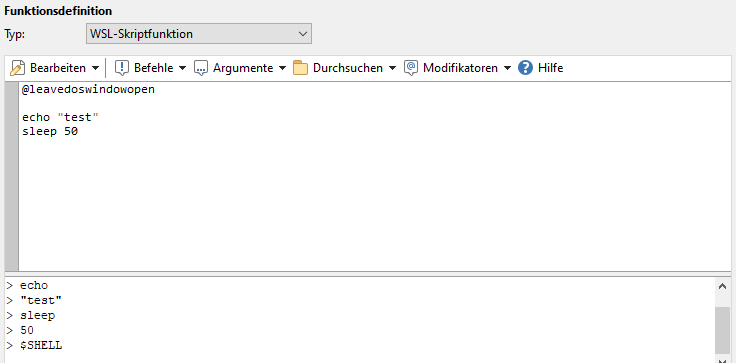

U meen the WSL-Scripfunktion? the have no effect or i understand the usage not her a example from me
a window pop fast up and close instand hmm no error and in log is noting to find ;(
the help page is emty.
https://docs.dopus.com/doku.php?id=:customize:creating_your_own_buttons:wsl_commands
Have u any hints how i can use it or on wat level it work?
wat do the WSL-Scripting? create it temp file like the MS-Batch or run it command for command?
wat Shell use it? :slight_smile:
