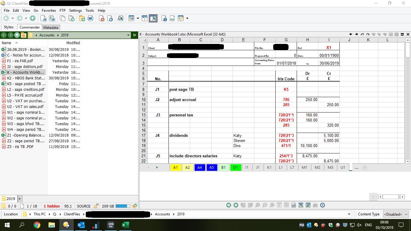

We are experiencing an issue where on both 12.16 and 12.17 versions an xlsx doc won't fill the viewer pane but if the mouse is pointed to where the sheet tabs should be, they are selectable. It does however work if you have any excel workbook open prior to previewing any xlsx doc. Any suggestions as to what could be causing it. Opus has to be quit and process killed for a user to then see the full preview pane.
Screenshot attached.

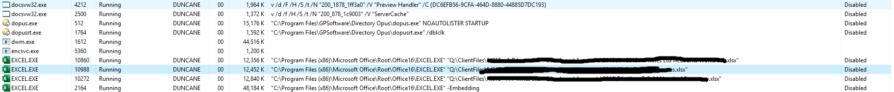

Image attached is what we are seeing when we are having the issue. Thats with excel closed and opus closed on screen. As discussed with explorer these files don;t stay open when viewing them through the viewer pane.

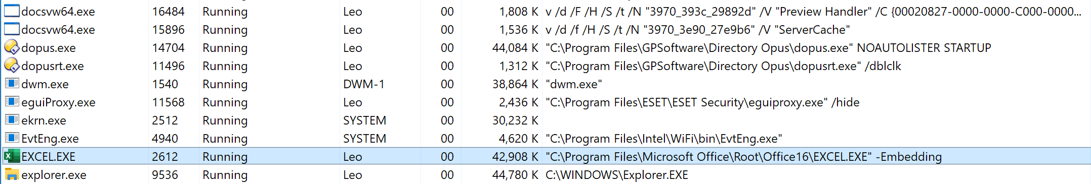

That looks like the viewer is currently open, which accounts for the first docsvw32.exe ("Preview Handler") and the last Excel.exe ("-Embedding").
The second docsvw32.exe ("ServerCache") is there to keep that same Excel ("-Embedding") process loaded for a few minutes after its last use, to speed up viewing subsequent files. That's normal as well, and will keep that one Excel.exe open for a while.
But the other three Excel.exe processes, with filenames on the command line, don't look like anything the viewer would open. Those look like someone has double-clicked those .xlsx files to open them in Excel (as in the application, not the viewer). I don't have any of those on my system when viewing an .xlsx file in Opus:
Do you see those processes start at the same time that files are opened in the viewer? It's possible some kind of Excel add-on or something in the sheets triggers it, which I don't have on my machine or in my test sheets. (e.g. VBA macros, although I'd be surprised if the Excel viewer runs them. But maybe there's something else.) But otherwise those processes look like instances of Excel that have been launched by double-clicking files and which aren't from the viewer.
