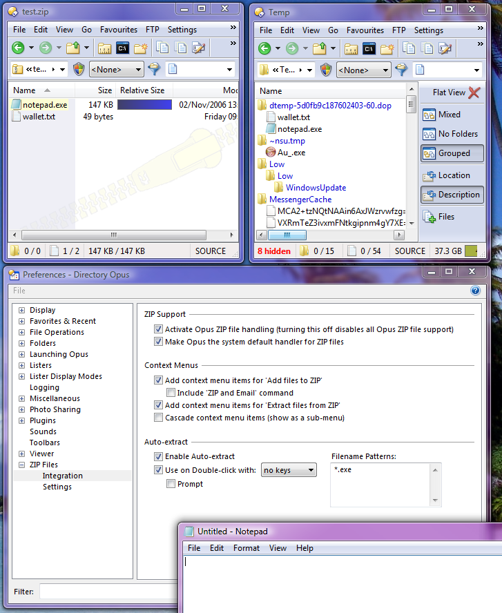

This seems to work for me. In the screenshot I've set the pattern to *.exe and I've just double-clicked notepad.exe on the left. On the right you can see that Opus has automatically extracted the contents of the zip to the temp directory.
It's possible that auto-extract doesn't work for *.jpg if you've got the Opus viewer set to handle JPG files. (I haven't tested this either way so it might work as well.) I can't think why you would want auto-extract turned on for *.jpg if you were using the internal viewer, though, so I'm guessing you're not?
