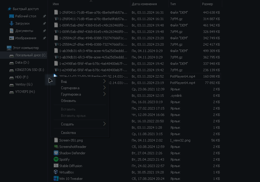

Hello! In my case i have opened my desktop folder in dOpus and i prefer to use Details view. So if i want to right-click on empty place i cannot. It's automatically open context-menu of the file. Not folder.
For example in default Windows Explorer i can right-click outside of file selection (left side as i wish).
Maybe i skipped some extra settings for it or i don't know how to figure it out.

Any chances to use little empty area at the left side of file/folder as empty area of lister in any future updates? Like Windows Explorer does?

I don't need more space before. I need to use already existed empty area in the same way as Windows Explorer.
Because this empty space already here in Opus but it can't be used as i need.
Like 10 years of PC usage if i want to drag&drop file i can do this right on this empty area. But now i can't. but opus so amazing and make no chance to come back to default Explorer. So i decide to ask on forum
