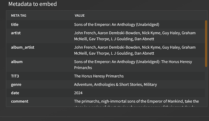

i dont think i have a example either, all i know is audiobookshelf mentions it here.
and here is what it seems to show in audiobookshelf it self
sorry i cant get better information, im trying to figure a lot of this out myself.
This does not look like a standard tag. Can you try to edit this tag from audiobookshelf in one file and then check with Opus and/or an id3 tag editor to see where the value you set appears?
From audiobookshelf:
