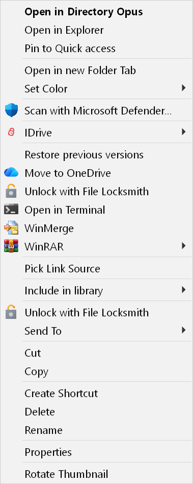

EDIT: I actually completely removed dopus 12 and installed it again. This is a screenshot of how it looks in "vanilla" state. So at least we can rule out any settings in dopus?

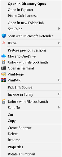

explorer view
dopus view
dopus context menu
as you can see the AMD radeon settings show up in both, but not the GIT ones. This is when I click on an empty space
However when I select A folder and right click
DOPUS
explorer

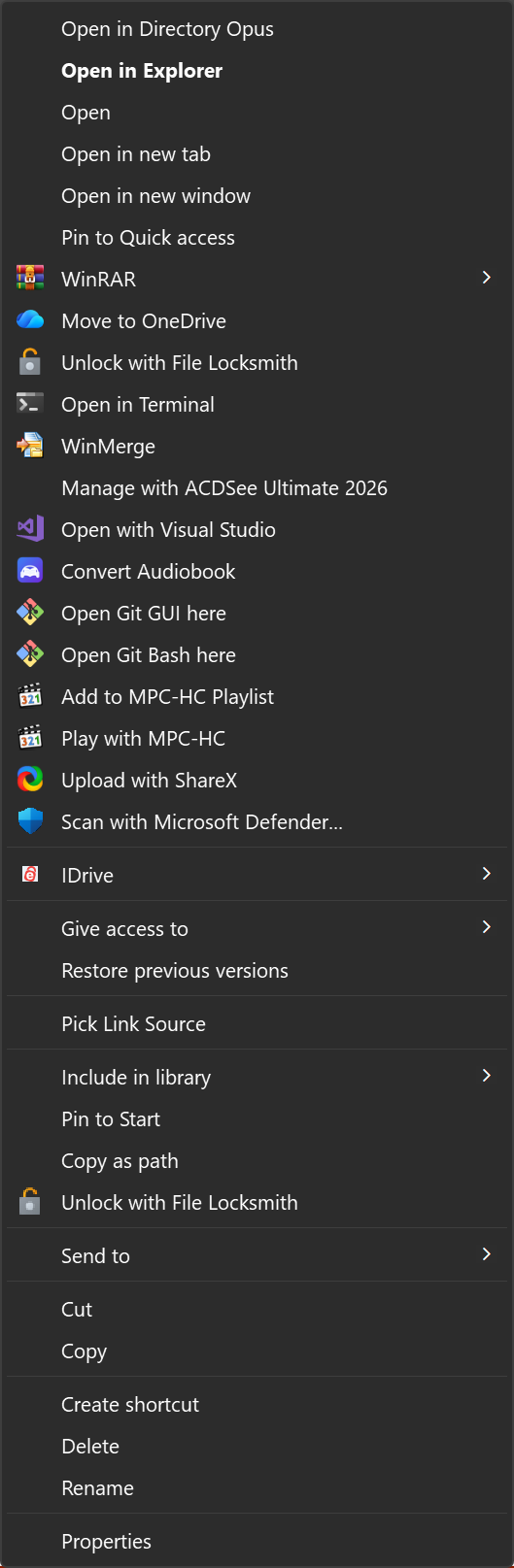

the first one is my right-click menu from Directory Opus and the second one is right-click menu from Windows Explorer.
The explorer one has Convert Audiobook option and the Opus one does not.
I tried the advices shared here, but nothing here.

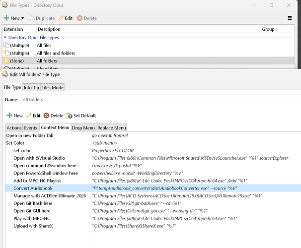

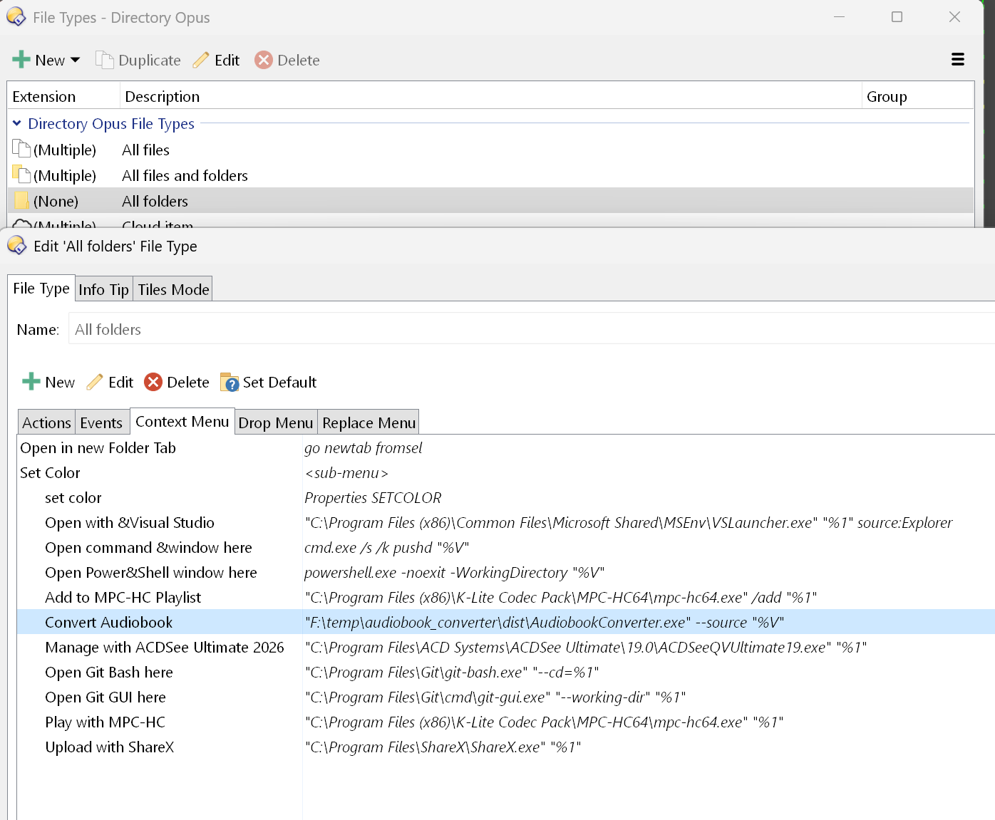

By the way it's also visible here, but still doesn't show in Opus right-click menu.
That screenshot shows it (and a bunch of other things) are inside the "Set Color" submenu. If you right-click the "Open with &Visual Studio" item and choose Decrease indent from the context menu it'll move all the items below it back to the top level of the menu.
oh, my...
thank you.
I have no idea how all this ended up there.
thanks again.
