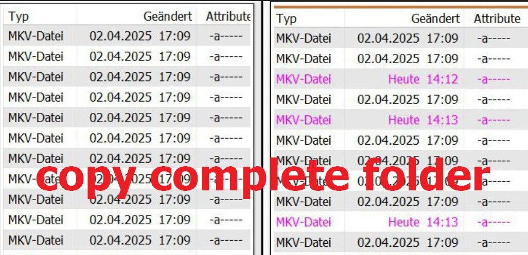

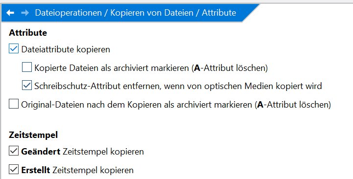

Copy from NAS (left) to external usb 3.0 drive (right)
USB drive is connected directly to the NAS. (transfer speed 205 mb/s.)

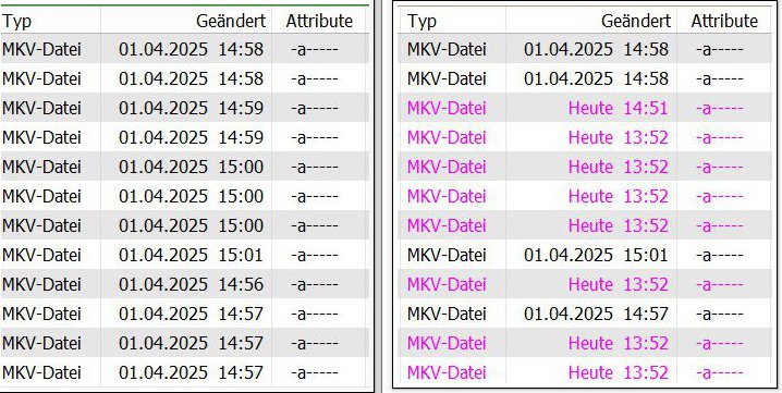

After copying new files, I noticed that some of them were given a current date and not the existing date.
examples
This occurs when all files are selected.
If you make a single copy of the file, the date remains correct.
If you use a different program and carry out the same operation with all files, the dates are also not changed.
It looks like DOpus is processing the files too quickly here and can't keep up with setting the original date and therefore skips some of them!
Any tips on how to transfer the data from the date,
without copying the files again?

On this USB drive, the existing date in the DOpus lister is often displayed as not applied.
When copying, the file with the current date is copied first
and then converted to the old date.
This sometimes takes a few seconds.
By the time the change appears, the copying process has already progressed by up to 10 files
This could possibly be the reason why some files remain on the current date.

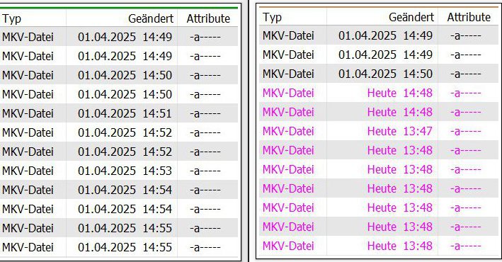

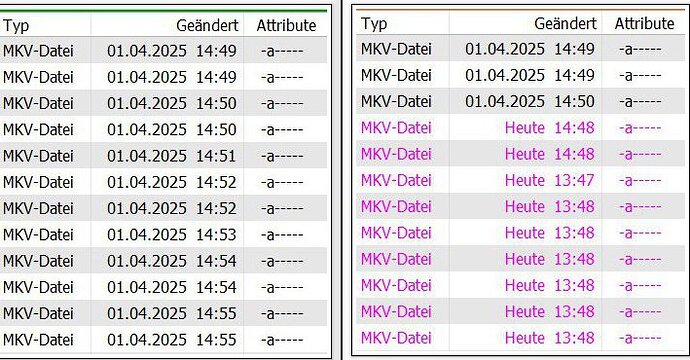

This also occurs with the same action from USB to USB
Multiple USB 3.0 devices via different connections (direct/hub/adapter)
Is it apparently the same phenomenon as here?
The same procedure was therefore tried as a test (deleting/copying files several times)
The results with the date were always different!

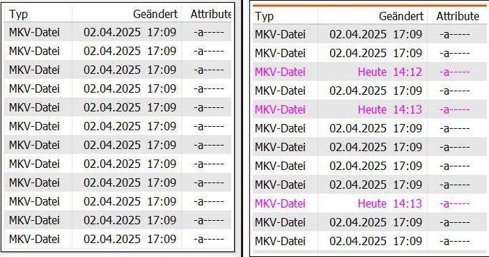

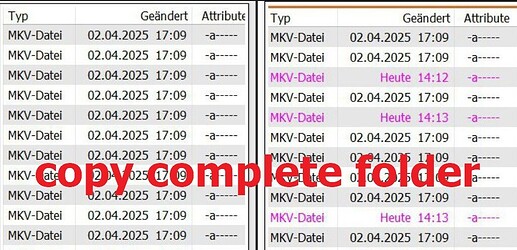

The source NAS is on the left-hand side of the duallist and the destination USB drive is on the right-hand side.
Zwischenablagebild (1)
The files are copied there as a complete directory.
This produces different results
Some files use the current date!
The 3 files in the picture are not correct.
