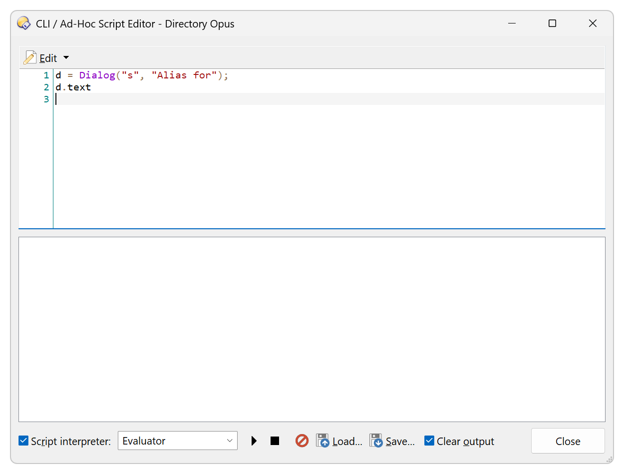

The {dlgString} can almost be replaced with an Evaluator Dialog() , but the returned value is a map, one part of which contains the new alias name .
It has the form of [choice: (button number), text: NewAlias] .
I don't know how to specify only that part.

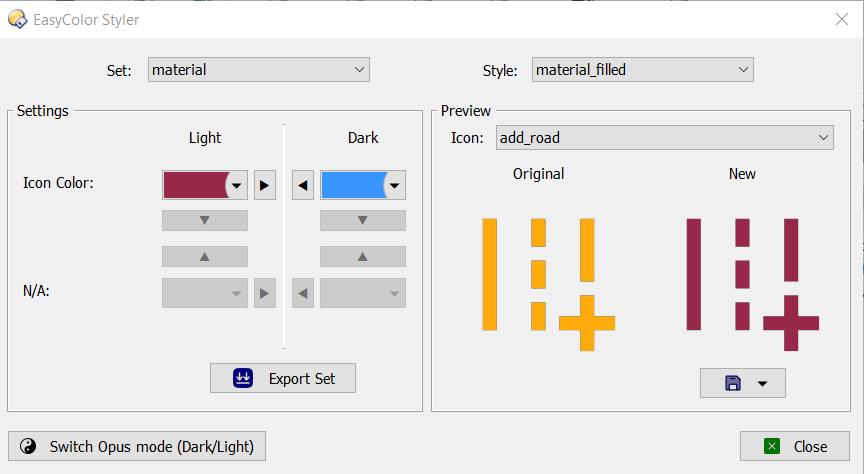

I found an icon that works well for this button.
It is an SVG icon found in @PassThePeas' EasyColor SVG iconsets .
The add_road icon found within the Material Filled icon set looks fine and can be colored to your liking in both light and dark mode.
