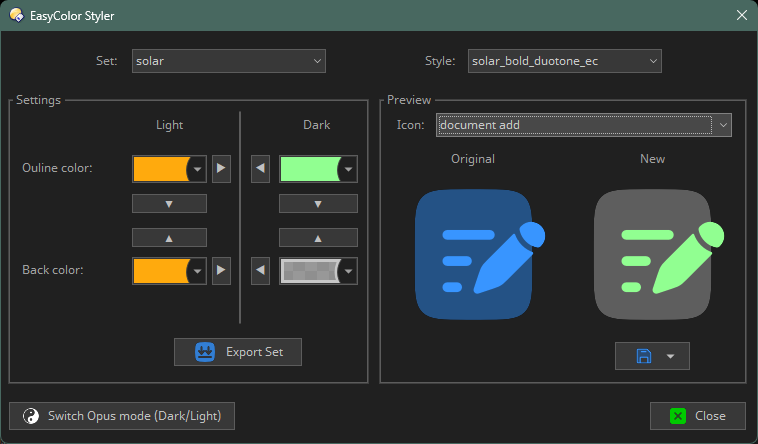

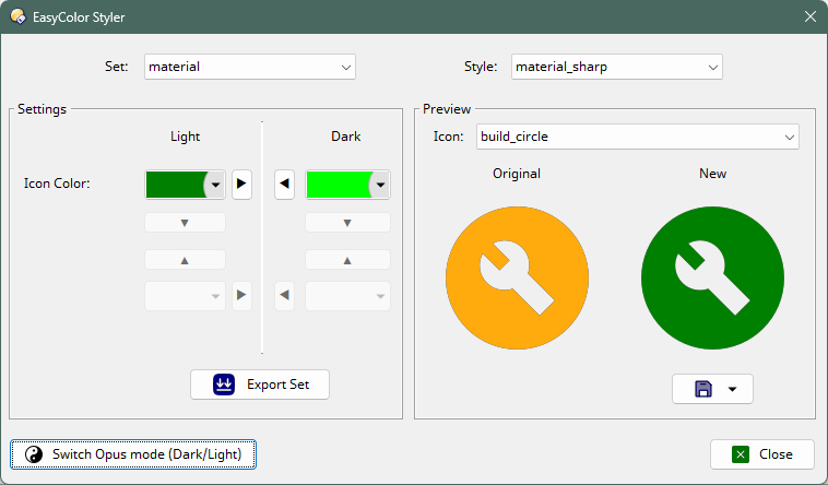

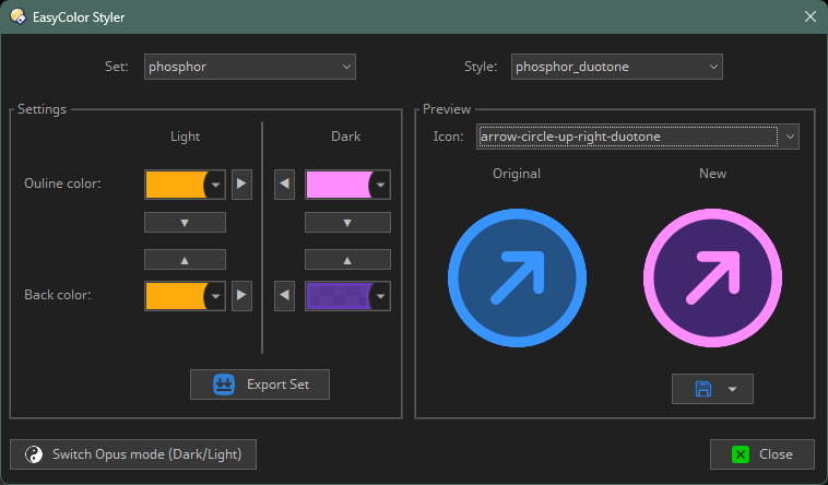

What is SvgEasyColorStyler
This is an Opus script addins that will make the recolor process easier.
For each provided set (see below), you'll be able to select one of its styles (outlined, filled, duotone, etc ...).
Then you can:
  • Chose each individual icon to check its rendering
  • Choose the main colors for dark mode and light mode, with a preview of the result
  • Switch the whole Opus interface to dark/light mode in order to better see how it renders
  • Copy the colors between main and secondary, and between dark/light modes
  • Export the resulting set with the customized colors

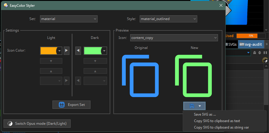

  • Export individual icons:
    • As standalone SVG files (including the proper styles properties)
    • As SVG code to the clipboard (so you can paste them in the SVG icon dialog for toolbar buttons)
    • As SVG code inside a JScript variable (so you can paste them into a jscript addins file and use them for the UI, using the DOpus.LoadImage(svgCodeAsVariable) method).

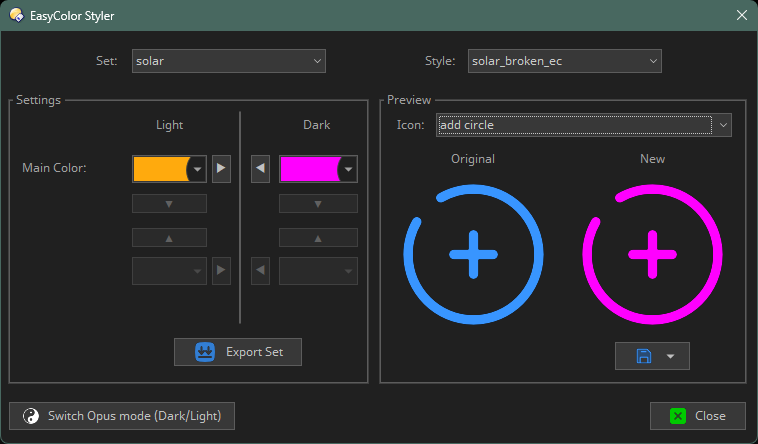

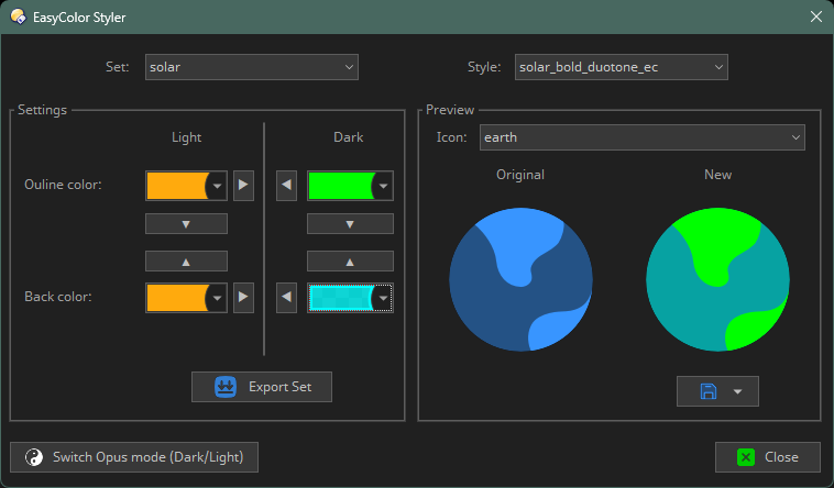

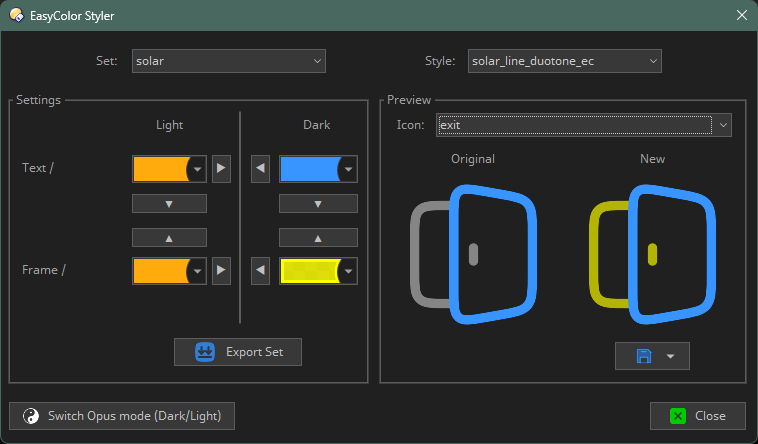

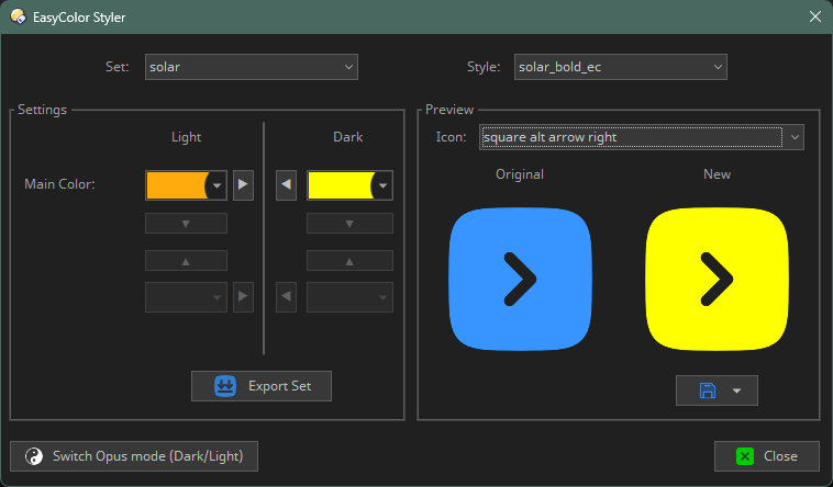

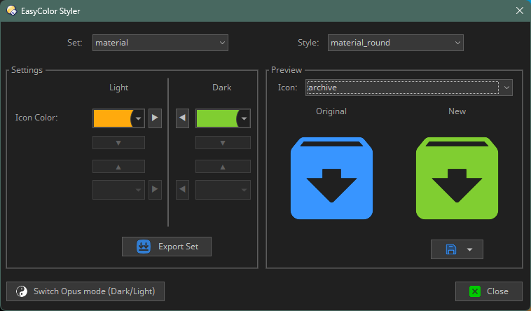

A few more screenshots:

        case "bCopyColorDark_1_2": // Main down to Fill (Dark)
            var srcDark = dlg.Control("palColor1Dark").value; // #RRGGBB
            var targetDark = dlg.Control("palColor2Dark").value; // #RRGGBBAA
            var alphaDark = (targetDark.length === 9) ? targetDark.substring(7, 9) : "7F";
            dlg.Control("palColor2Dark").value = srcDark + alphaDark;
            UpdateIconPreview(dlg);
            break;
        case "bCopyColorDark_2_1": // Fill up to Main (Dark)
            var cDark2 = dlg.Control("palColor2Dark").value; // #RRGGBBAA
            dlg.Control("palColor1Dark").value = cDark2.substring(0, 7);
            break;
        // --- Major Engine Actions ---
        case "bSetAction":
            ExportMasterIconSet(dlg);
            break;
		case "bIconAction":
            if (msg.event === "click") {
                HandleIconActionMenu(dlg);
            break;
		case "bToggleDLmode":
			var toggleCmd = DOpus.Create.Command();
			toggleCmd.SetModifier("toggle", "disable"); // Gère l'état visuel du bouton si nécessaire
			toggleCmd.RunCommand("Set DARKMODE=togglesmart");
            SetButtonIcons(dlg);
			break;
    return true;
// CONTEXTUAL POPUP MENU FOR SINGLE ICON ACTIONS (Native Menu Object)
function HandleIconActionMenu(dlg)
    if (!currentDriver || !currentXmlDoc || !lastCompiledPreviewSvg || !singleSvgMenu) return;
    var cbIconCtrl = dlg.Control("cbIcon");
    if (cbIconCtrl.value < 0) return;
    var selectedIconName = cbIconCtrl.GetItemAt(cbIconCtrl.value).name;
    // 1. Display popup menu anchored under bIconAction button control
    var menuResult = singleSvgMenu.Show(dlg, "bIconAction", "r");
    // 2. Handle user cancelled menu
    if (menuResult === -1) return;
    // 3. Process according to id selected by user
	DOpus.Output("User selection = " + menuResult);
    switch (menuResult) {
        case 1: // Save SVG as a file...
            var defaultName = sanitizeFilename(selectedIconName) + ".svg";
            var savePath = DOpus.Dlg.Save(
				"Export icon as SVG file",
				defaultName,
				dlg,
				"SVG Files (*.svg)!*.svg"
            if (savePath) {
                try {
					ExtSystem.WriteFileUTF8(savePath, lastCompiledPreviewSvg, false);
                } catch(err) {
                    DOpus.Dlg.Request("Unable to write SVG file (" + savePath + "):\n" + err.description, "OK", "Erreur d'écriture", dlg, "e");
            break;
        case 2: // Copy raw SVG code to clipboard
			DOpus.Output("Setting clipboard as ='" + lastCompiledPreviewSvg + "'");
            DOpus.SetClip(lastCompiledPreviewSvg);
            break;
        case 3: // Copy raw SVG code as a JSCript variable
            var jscriptVariable = "var svg_" + sanitizeFilename(selectedIconName).replace(/[^a-zA-Z0-9]/g, "_") + " = ";
            var lines = lastCompiledPreviewSvg.split("\n");
            for (var i = 0; i < lines.length; i++) {
                var cleanLine = lines[i].replace(/\\/g, "\\\\").replace(/"/g, '\\"').replace(/\r/g, "");
				if (i > 0) jscriptVariable += "\t"; // After first line, we have an indent
                jscriptVariable += '"' + cleanLine + (i === lines.length - 1 ? '";' : '\\n" +\n');
            DOpus.SetClip(jscriptVariable);
            break;

    // --- Process Palette Configuration Styles ---
    var darkC1  = dlg.Control("palColor1Dark").value;
    var lightC1 = dlg.Control("palColor1Light").value;
    var darkC2  = currentDriver.hasColor2 ? dlg.Control("palColor2Dark").value : "";
    var lightC2 = currentDriver.hasColor2 ? dlg.Control("palColor2Light").value : "";
    var compiledDarkCss  = ProcessCssTemplate(currentDriver.templates.dark, darkC1, darkC2);
    var compiledLightCss = ProcessCssTemplate(currentDriver.templates.light, lightC1, lightC2);
    var styleDarkNode = exportXmlDoc.selectSingleNode("//style[@id='dark']");
    var styleLightNode = exportXmlDoc.selectSingleNode("//style[@id='light']");
    // Rewrite raw style blocks without wrapping into unwanted CDATA nodes
    if (styleDarkNode) {
        styleDarkNode.text = "\n" + compiledDarkCss + "\n\t";
    if (styleLightNode) {
        styleLightNode.text = "\n" + compiledLightCss + "\n\t";
    var baseRoot = DOpus.FSUtil.Resolve(Script.config["Sets location"]);
    var exportPath = DOpus.FSUtil.NewPath(baseRoot);
    exportPath.Add(sanitizeFilename(chosenName) + ".xml");
	try {
        exportXmlDoc.save(String(exportPath));
		// === Zipping the XML into a .dis archive
		DOpus.Output("Export XML OK >> Now zipping to .dis iconset file ...");
		var zipCommand = DOpus.Create.Command();
		zipCommand.SetModifier('noprogress');
		zipCommand.SetDest(baseRoot);
		zipCommand.AddFile(exportPath);
		zipCommand.RunCommand('Copy ARCHIVE CREATEFOLDER="' + sanitizeFilename(chosenName) + '.dis"');
        DOpus.Dlg.Request("Iconset compiled and exported successfully!\n\nDestination:\n" + exportPath, "OK", "Export Success", dlg, "i");
    catch (e) {
        DOpus.Dlg.Request("Failed to save the target XML file:\n" + e.description, "OK", "Disk Write Protected Error", dlg, "e");
function ProcessCssTemplate(templateStr, color1, color2WithAlpha)
	// DOpus.Output("ProcessCssTemplate: color1=" + color1 + " / color2alpha=" + color2WithAlpha);
    var c1 = color1;
    var c2 = color2WithAlpha.substring(0, 7);
    var opacity = "1.0";
    if (currentDriver.color2HasOpacity && color2WithAlpha.length === 9) {
        var alphaHex = color2WithAlpha.substring(7, 9);
        opacity = (parseInt(alphaHex, 16) / 255).toFixed(2);
    var output = templateStr;
    output = output.replace(/%COLOR1%/g, c1);
    output = output.replace(/%COLOR2%/g, c2);
    output = output.replace(/%OPACITY2%/g, opacity);
    return output;

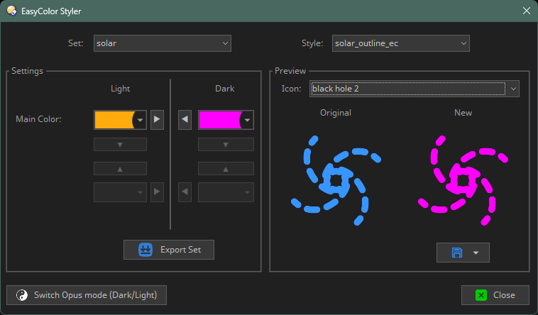

// UPDATE SVG PREVIEW CONTROLS (Using single memory DOM parser instances)
function UpdateIconPreview(dlg)
    if (!currentDriver || !currentXmlDoc) return;
	var iconNode = null;
	// Retrieve all icon elements flat and find the matching node via standard loop to avoid MSXML XPath whitespace crash
	var allIconsList = currentXmlDoc.getElementsByTagName("icon");
	for (var j = 0; j < allIconsList.length; j++) {
		if (allIconsList.item(j).getAttribute("name") === selectedIconName) {
			iconNode = allIconsList.item(j);
			break;
	if (iconNode == null) return;
    var svgNode = iconNode.selectSingleNode("svg");
    if (!svgNode) return;
    var rawSvgText = svgNode.xml;
    // 1. Gather values from UI palette controls
    // 2. Compile CSS templates for each specific theme target
    // 3. Build native Opus style tags with matching IDs for the live Preview
