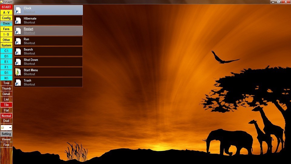

I did a really quick mokeup of it using a floating toolbar with the toolbar Type set to "taskbar" so the toolbar matches the taskbar. (Sorry for the large size, I wanted to show the full desktop and 7's taskbar)(yes, my Windows color is Black and it is transparent, just not that evident with that background) :slight_smile:

It does have one major problem (see the two attached jpegs... below)...
1: When not floating... the bar has my custom wood background.
2: When floating... it turns to a plain solid brown.
This may simply be a setting somewhere.. any ideas?
Now this is weird; I just noticed that both JPEGS show the wood grain background yet the actual floating bar on screen does not. It will, for a few milliseconds show the wood grain as the bar retracts. What is with that?

Inspired by Ktbcrash, I have changed my menu to Windows Task Bar look (semi-transparent). SEE: the attached New Taskbar-type Menu.jpg (below).

New Transparent Menu with icons.

Here's 'ol sleepy-eyes with a new update...
1: Dual-size Icons
2: New Fonts
3: Custom Line Spacing
Think I'll take a short nap!
Cheers;
Doc
