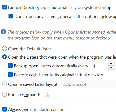

This remains my biggest annoyance with DOpus as every single restart I have to press a button restoring the latest saved state (and had to write a special plugin saving those states to be restored).
But I’ve just potentially discovered a more narrow cause: disabling Preferences / Launching Opus / Startup / Launch Directory Opus automatically on system startup with Don't open any Listers (otherwise the options below apply) and then restarting doesn’t seem to destroy my precious tabs anymore.
And after the DOpus is launched after a restart the openlisters.oll file is intact, so the issue in this case seems to be not data being lost, but that it’s simply being ignored when I open a new Lister. This new Lister behaves as though there were no listers saved on previous close. (although given the fact that openlisters isn’t updated when lister is closed, but only when DOpus is closed, maybe the fact that the file exists isn’t a good indicator??)
Haven’t tested it much, but hopefully this would be a partial workaround at the cost of a slower startup (the close/new is still not solved)

  • Is the Preferences / Launching Opus / Startup / Backup open Listers automatically every option turned on? That can change when openlisters.oll is saved, so we should do our tests with the same setting you have.

backup open
Yes, these are my options

It’s just that the first lister with Preferences / Launching Opus / Startup / Don't open any Listers (otherwise the options below apply)is not the backed up lister, but the default one, which I’ve confused with the backed up lister not being properly restored.
